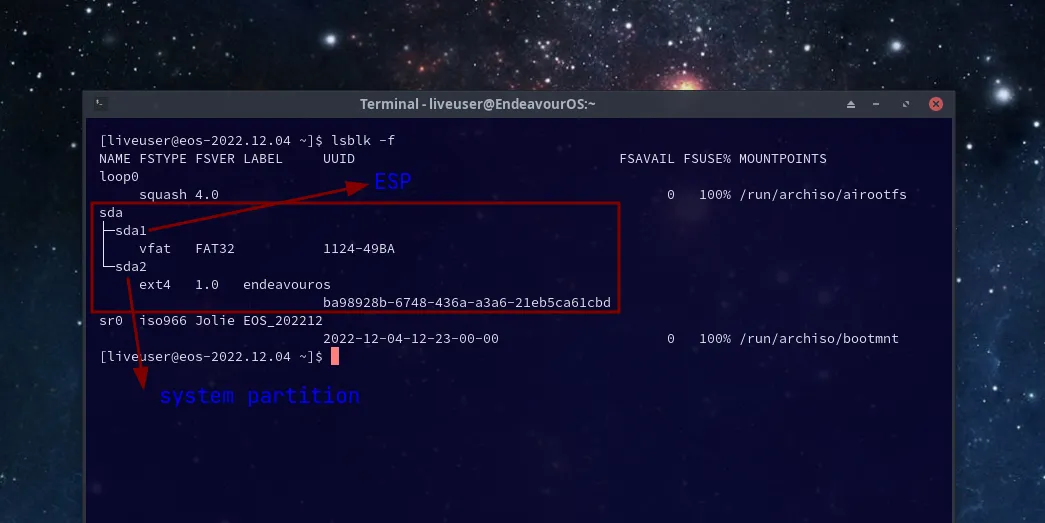

To uncover that information, open the terminal, and type:
sudo lsblk -f
Depending on the way you installed the OS you will have different scenarios.
It can be ext4, BTRFS, or xfs formatted and you may set up encryption.
On most modern systems, and if you do not set legacy Bios Mode on the Firmware, you will run in EFI mode, and in this case, you will have a fat32 partition (ESP = EFI-System-Partition) and your system partition if using ext4 or xfs. If you are using BTRFS you have a subvolume scheme running.

In this example, we use a default ext4 setup with the ESP mounted under /efi ( you will find other models at the end of the article).
lsblk -f
So we need to mount /dev/sda2 and the ESP (/dev/sda1) make sure to know your ESP mount point on your installed system can be /efi or /boot/efi (older installs, or if you are using grub instead of systemd-boot).

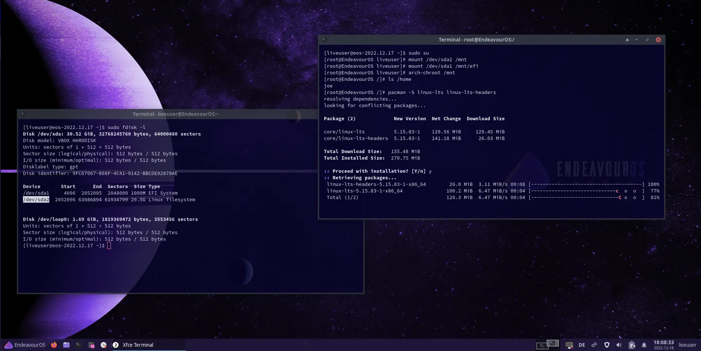

Run arch-chroot to login to the installed system
Section titled “Run arch-chroot to login to the installed system”With this information, you are able to arch-chroot, so type the following command:
sudo arch-chroot /mnt
Now you’ve chrooted into your installed system, and you are able to access your files, install packages, or alter scripts to rescue your system.
To make sure arch-chroot is working check after your user’s home folder ls /home that should give your username from the installed system.
All commands you run into this terminal will now run as you would run them on a real boot of the system.
You can rerun a failed update, rebuild kernel images or reinstall uninstalled packages and fix configs, etc.

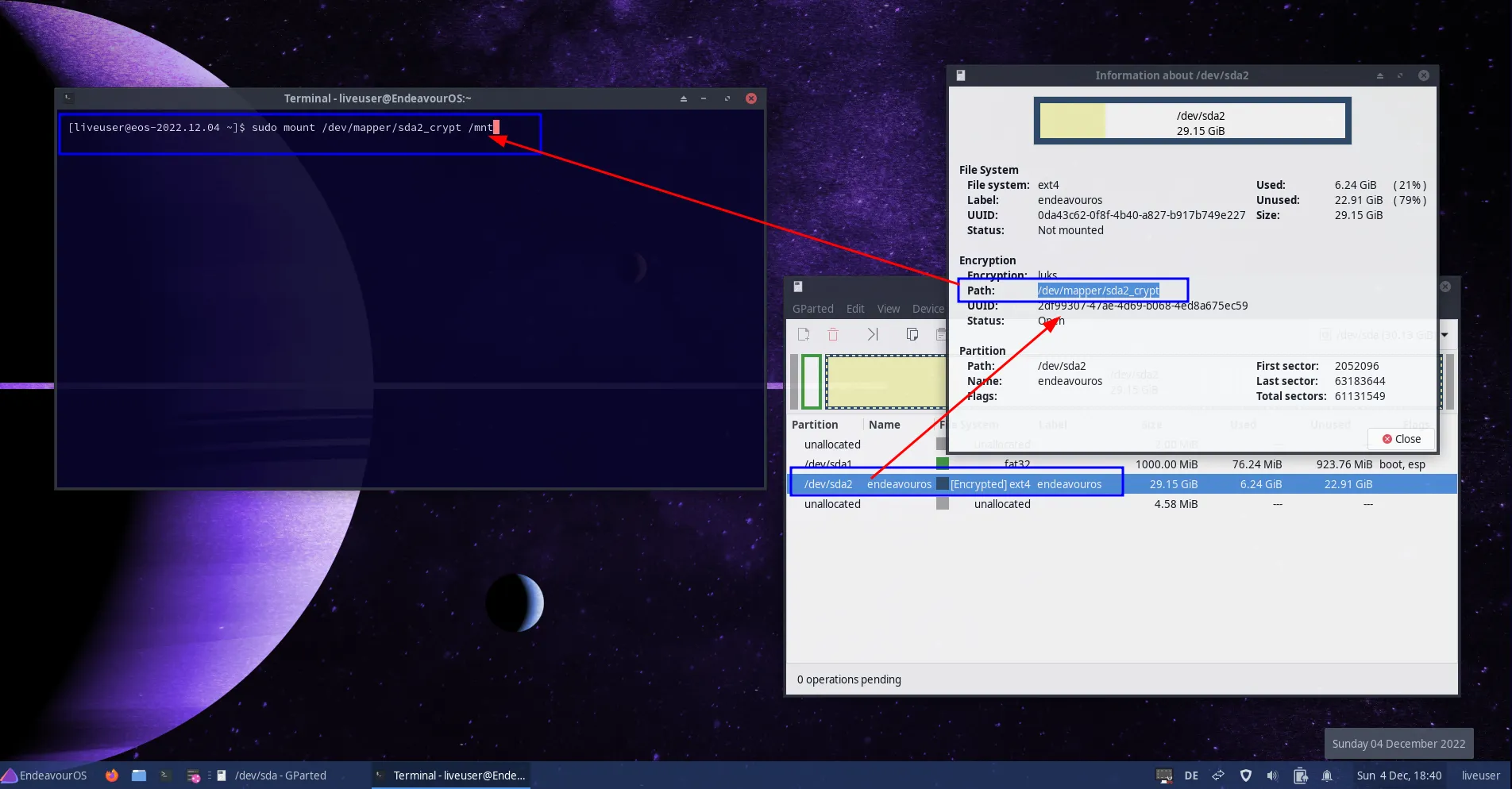

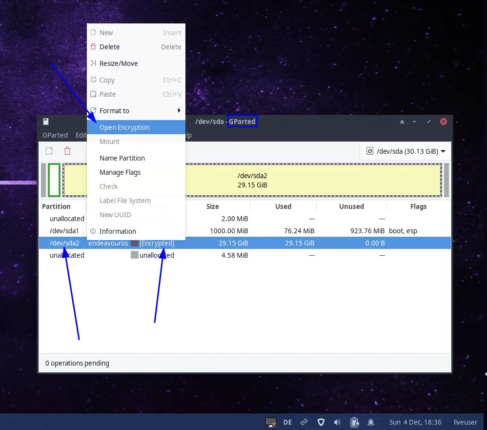

You can also use Gparted to open encryption…
open encryption - Gparted
After this right-click on the partition and show “information” to get the mapper path you need to mount it:
rescue livesession - gparted
