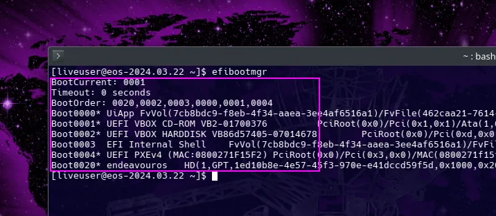

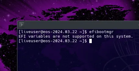

To validate if you are on UEFI or not run:
efibootmgr
It Will show like so if you are booted in UEFI mode.
And like this if you are booted in Bios legacy mode (MBR)

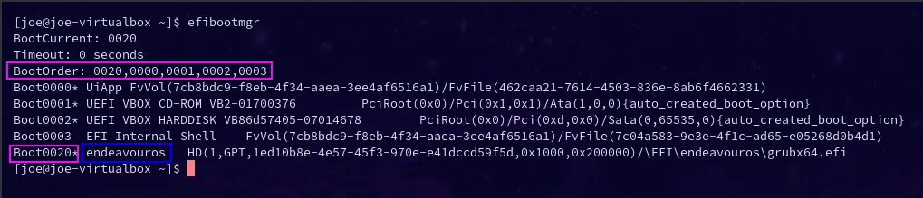

Before you are going to repair GRUB, you should also check your EFI-boot-settings, this also can be the reason why GRUB isn’t booting.
  1. reinstall GRUB files:
Only grub-install is needed no need to add any options, at least on EndeavourOS where we use the default efi-path /boot/efi what is the default used for the command already. The --bootloader-id option will create a new entry with the given ID that in some cases will not get set as the default boot entry in the firmware.
If not used it will use the GRUB_DISTRIBUTOR= entry from the grub main config in /etc/default/grub, in case this is not the same as used before for bootloader-id it will create a new entry.
default boot entry in this example is 0020 that has the bootloader-id endeavouros (default set one)
