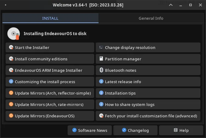

INSTALL
Section titled “INSTALL”This window is what you’ll see when starting to install EndeavourOS:
This is the contents of the INSTALL tab. The tab is available only in the install phase.
Note: some buttons may not show as above, depending on the installed software or new/changed features of Welcome.
To start the install process, simply click the Start the Installer button. This will allow selecting from a few popular desktop environments, or even no desktop at all. In addition to the installer window, it starts a terminal window that shows plenty of detail of the install process.
Another installer button Install community editions allows installing editions with a window manager (currently: Sway, Bspwm) instead of a desktop environment. Also, you can start ARM version install on ARM hardware.
Button Update Mirrors (toolname) starts program reflector-simple or rate-mirrors which helps you select the Arch mirrors to use. This is very useful for the online install mode (that you may choose a bit later during the install) as it can speed up the install process quite dramatically. Another button can update the EndeavourOS mirrors.
The Change Display Resolution button (added in Welcome version 3.4.7) helps you to change display resolution. Note that, by default, this button is active only in a virtual machine (supports VirtualBox, VMware, and QEMU). This may be useful if you want to change the VM window size and your display is large enough. It is also useful in the live session if you have a high resolution monitor, and text and other things look too small to work with.
The above feature is implemented on top of the xrandr command, so package xorg-xrandr must be installed.
If certain disk management functions like special partitioning or partition formatting is needed, button Partition manager may help you.
The Bluetooth notes button shows information how to enable bluetooth functionality. We do not enable bluetooth by default due to reasons mentioned in the page the button opens.
Buttons Latest release info, Installation tips, and How to share system logs should be self explanatory – they will show you related EndeavourOS web pages in a browser. Note that the last of these 3 buttons is a useful tool for troubleshooting.
Button Fetch your install customization file (advanced) is meant for power users to customize the install to a certain degree (like adding/removing packages, customizing features, etc.). This feature is explained in more details in other Discovery articles.
The bottom line buttons are:
- Software News button shows important “last minute” information about the EndeavourOS software and its changes. Be sure to click this! The button goes here.
Note that it will be available also in the installed system. - Changelog button provides a view to version history of the Welcome app.
- Help button shows the discovery article about Welcome.
- Don’t show me anymore button is meant to silence (i.e. not start automatically) the Welcome app until you explicitly enable it again. To enable the Welcome app is easy – just click the Welcome icon in the start menu.
- See you later button closes this window. Note: this button is no more available.
Note that if you want to customize the install process, see this.

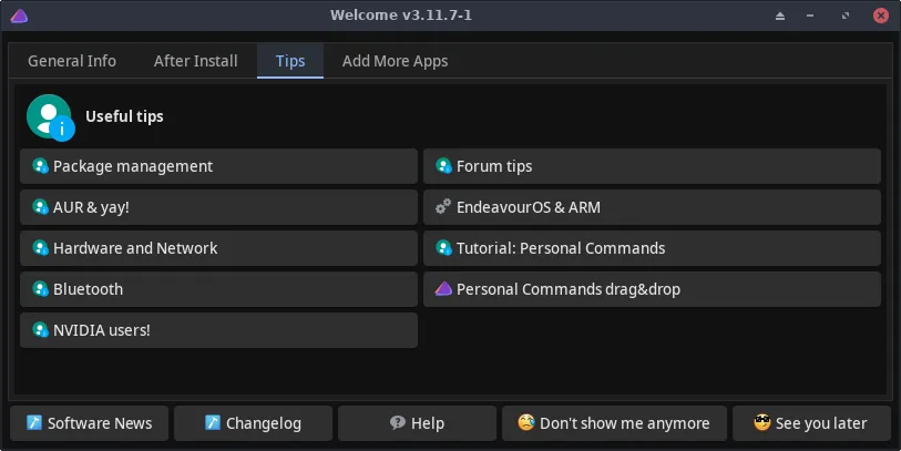

Section titled “General Info”The next tab contains links to general information about EndeavourOS. This may be quite useful for users that know very little or nothing about EndeavourOS.
The General Info tab contents look like this:
As you can probably guess, the buttons contain links to much more information at the EndeavourOS web site.
And since developing and maintaining a distribution takes resources that the development team must pay for, we’d appreciate any size of donation (the Donate button) to help us cover the mandatory costs.

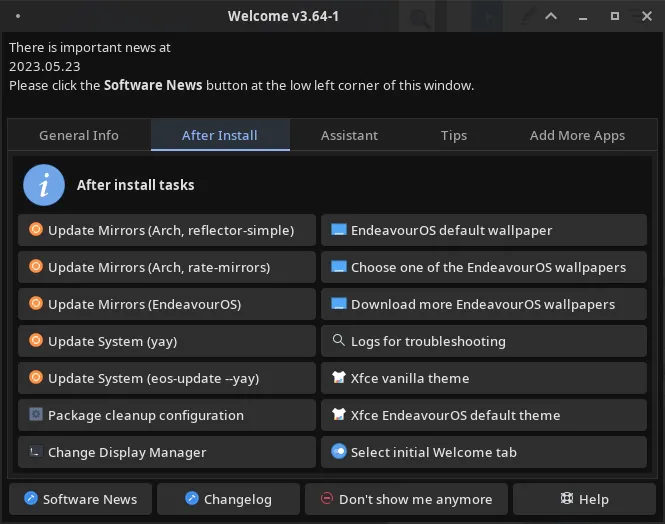

Section titled “After Install”Note you’ll see the following Welcome tabs after you have installed EndeavourOS, rebooted, and logged in to your new system. The General Info tab has the same contents now as while installing.
The next tab is (as some might say) where the real fun starts!
This tab (and the last tab) are meant to be used (mainly) in the installed system.
On the picture you can see text above the tabs. This is an embedded notification area in Welcome, and is meant for informing users about important events or matters. To see the contents of the notification, simply click the Software News button. Note that the notification are can be empty too, but the Software News button is still available.
The Update Mirrors (repo, tool) button may be good to click as the first thing after logging in the first time, especially if software updates seems (see the Update System button below) very slow, or even break. It creates a list of “good” mirrors for your system. And you’ll use precisely those mirrors when updating the system, or installing new packages to it. Note that you may use this button also at a later time, for example if any of the listed mirrors is no more available, or should you have other problems with mirrors.
These buttons run commands reflector-simple, rate-mirrors, and eos-rankmirrors respectively. You can run them from the terminal as well.
The next buttons, Update System (command), are important buttons. Click any of them right after booting to the installed system (maybe after “Update Mirrors” operation has finished), and your system will be up-to-date (and may need to be rebooted). These buttons can be used later as well, always when a system update is needed.
Tip for NVIDIA graphics hardware users: the eos-update command can check on kernel (with option --nvidia) updates (linux and linux-lts) that the required NVIDIA driver (nvidia or nvidia-lts) will also be updated! This helps preventing problems when a kernel is updated but the required NVIDIA driver is not.
In addition, eos-update will take care of updating Arch and EndeavourOS keyrings before updating other packages. This should help handling the situation when either of the keyring packages are updated.
Tip: it is recommended to update system software at least about once a week. Note that new package updates will be available very frequently, often many times a day. Systems that haven’t been updated for a very long time (like months or even years) usually can be updated, but may require extra work. The EndeavourOS forum will help you in case of any trouble.
After updating all packages your system is ready to be used.
After you have been using your EndeavourOS system for a while, your disk (more precisely, the package cache) may fill up with old packages that are stored there for convenience. Eventually it may contain gigabytes of old packages that are no more used! So in order to remove the unneeded old packages automatically, button Package cleanup configuration was added. It helps configuring the service that automatically removes old packages, and saves the number of packages that you want to keep. By default it keeps 3 versions of each package, but for many purposes 2 would be enough, and even 1 if your disk doesn’t have much free space.
Another useful maintenance button is Configure eos-update-notifier. It helps configure the app that, by default, notifies about available updates according to a schedule, and lets you do the actual system update as well. You can, for example, schedule update checks to occur weekly instead of daily (=default).
You may change the Display Manager by clicking the Change Display Manager button. Usually this is not needed, but you may have a reason for doing so.
The EndeavourOS default wallpaper button assigns the default EndeavourOS wallpaper back. This may be handy after experimenting with other wallpapers. Note also that this button uses the program eos-wallpaper-set, and that program can be used to set the wallpaper directly on the command line.
There are two related wallpaper buttons. Choose one of the EndeavourOS wallpapers lets you choose another wallpaper from a predefined location of wallpapers. You may browse with this application and select other wallpapers as well.
Then Download more EndeavourOS wallpapers gives a possibility to download and use the legacy EndeavourOS wallpapers, or wallpapers made by the EndeavourOS community members. So, if you are artistically oriented, you have the opportunity to contribute!
Logs for troubleshooting helps you create many logs at once, and send them to a pastebin service on the internet. These logs are very useful in troubleshooting issues especially if you want other fellow users to help you e.g. on the EndeavourOS forum. Note that you may look at the logs before sending them to pastebin - any personal information should be hidden in the logs.
Select initial Welcome tab lets you choose the tab Welcome open to. Often users want to open to the next tab, the Assistant, which will be explained a bit later.
If you installed Xfce as your desktop, then you’ll see the related Xfce buttons. They can be used for changing the theming (appearance) of the desktop. The Xfce vanilla theme puts the vanilla theming in place. The Xfce EndeavourOS default theme sets up our default theming. Note that the offline install mode provides the latter, but the online install mode results in the vanilla theming. Note also that both options will bring the default theming, and your own modifications are not included – but your old theming is saved if you want to go back. The buttons will give more instructions about that.

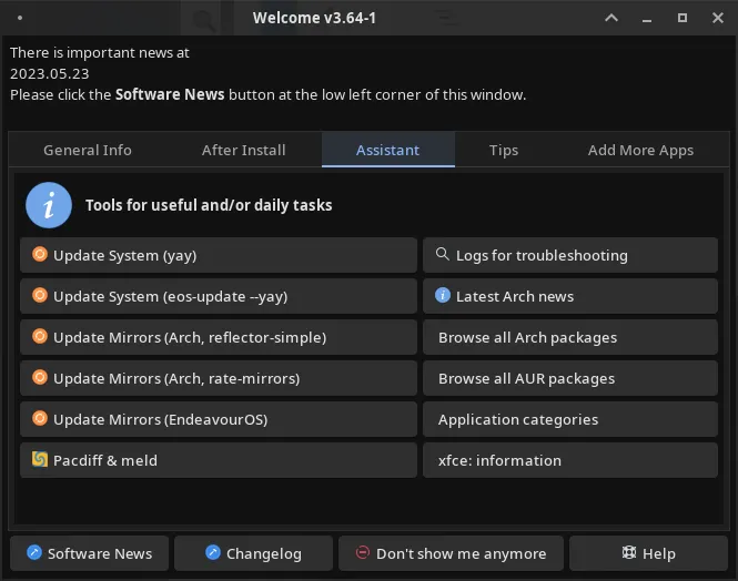

Assistant
Section titled “Assistant”This tab consists of a collection of most useful buttons. Some buttons have already been explained, and some are new, which are explained here.

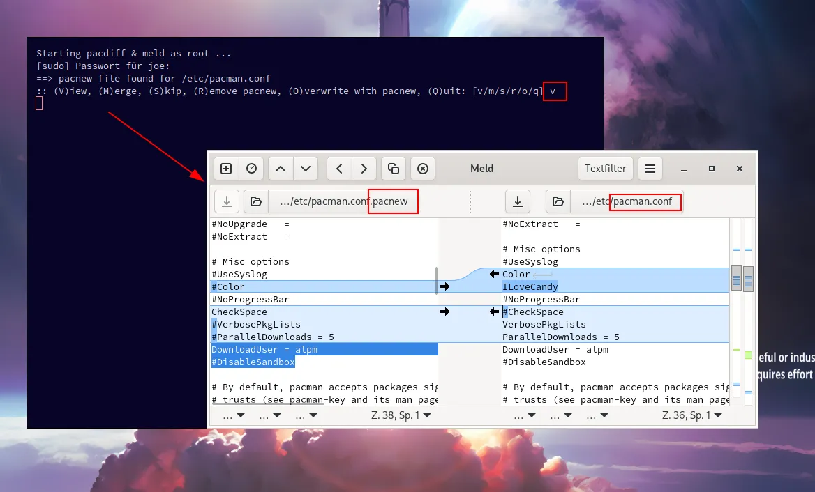

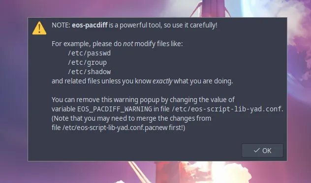

The Pacdiff & <diff-app> button is meant for managing certain configuration files (e.g. *.pacnew) and their changes. Pacdiff is a program that walks through the changed configuration files one by one, and lets you view the changes with the <diff-app> to possibly merge the changes you’d like to include. The <diff-app> is typically meld but can be changed to e.g. kdiff3 or another suitable for you.
Related configuration: EOS_WELCOME_PACDIFFERS, see more about this later in this document.
The following picture shows pacdiff in action:
Button Latest Arch news will open a web page showing the latest Arch news. This is useful e.g. for finding out latest developments or potential need for manual intervention because of recent changes by the Arch devs.
Buttons to browse Arch or AUR packages, and the Application categories button are links to web pages that contain valuable information about various applications in a well organized manner.
You may also see a button (above: xfce: information) which will show information about the currently used DE (Desktop Environment).

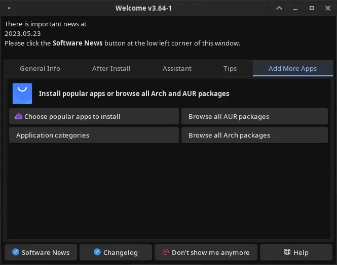

Add More Apps
Section titled “Add More Apps”The last default tab includes buttons for installing some popular applications.
Button Choose popular apps to install opens an app that helps you to install apps from a curated list. Other buttons should be familiar from the Assistant tab explanation above.
Even though the apps in the curated list are popular and useful, we’ve chosen not to install them by default. This gives users a better opportunity to “tailor” their system, but still, have an easy way to install these apps.
By the way, do you remember that the previous tab included a button AUR & yay!? As you (should!) know by now, pacman is the main package manager in EndeavourOS. It manages packages that are available from the Arch Linux repositories. But there is a huge amount of more apps available in the AUR (Arch User Repository). AUR is not managed by pacman. That’s why EndeavourOS provides another package manager, yay. It is like pacman, but supports AUR applications in addition to Arch Linux repositories.

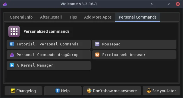

Section titled “Personalizing Welcome”Welcome version 3.0 introduced a new feature: users can personalize Welcome by adding their own command buttons.
Here’s an example what it might look like:
You can see a new tab Personal Commands and some command buttons are already added in the picture above.
The new tab will be activated only if the configuration file
$HOME/.config/welcome-own-commands.conf
exists, and the file contains command definitions.
The first button Tutorial: Personal Commands will be automatically created, and it shows a short tutorial about how to create new Welcome commands. Check that out!
The next button, Personal Commands drag&drop starts a window (called a dnd window) where items can be dropped. As you probably remember, the same two buttons appeared also under the Tips tab. They are on both tabs for convenience.
There are two ways to create the configuration file. One is to manually write the file, and the other (the easier way) is to use button Personal Commands drag&drop and drop items to the dnd window.
If you don’t already have the Personal Commands tab available, click the same button under the Tips tab.
Dropping items to the dnd window will cause
- the configuration file to be created if it doesn’t exist
- the configuration file to be updated with button definitions
- the Welcome app to instantly contain the new buttons!
Now your part begins! All additional buttons on this tab are there because you (the user) will add or have added them there.

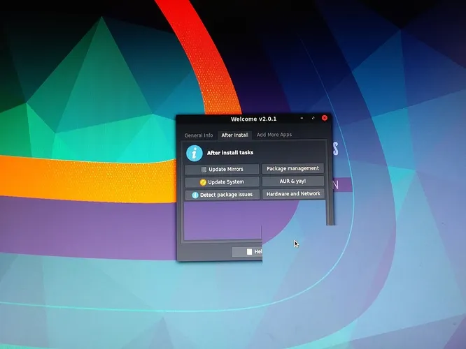

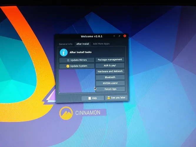

Section titled “Cinnamon”Community member and Moderator Ricklinux discovered a bug that affects the Welcome app on the Cinnamon desktop and it looks like this:
Until now a solution hasn’t been found but the workaround is simple. Go to the preferences menu and disable window effects like this:
