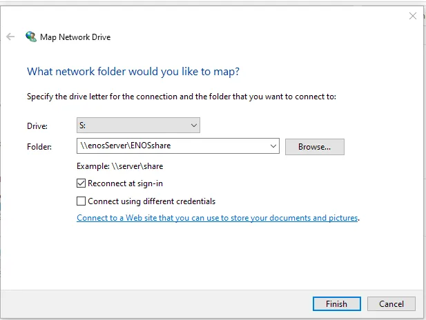

Click on the “This PC” icon –> Computer Tab –> “Map Network Drive” to get the following:
In the “Drive” pull down, select S: for the drive letter to mount Samba Share to, or any other drive letter of your choice.
In the “Folder” pull down enter \enosServer\ENOSshare
ENOSshare is case sensitive
Make sure “Reconnect at sign-in” is checked
Click Finish. You will get a dialog box saying Trying to connect
Then a box asking for username and password.
Enter pshare for user and pshare’s Samba password that we established with # smbpasswd -a pshare
Make sure “Remember my credentials” is checked.

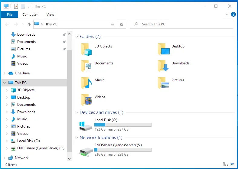

Go back to “This PC” and in addition to Local Disk (C:) you should see the ENOSshare mounted as Drive S: under the Network Locations header.
If you have the ENOSshare mounted and listed as above, restart Windows and see if the SMBshare is automatically mounted after logging in. If it automatically mounts at boot up, we are done with Samba. Sometimes after login, the Icon for enosServer will look like the following.
