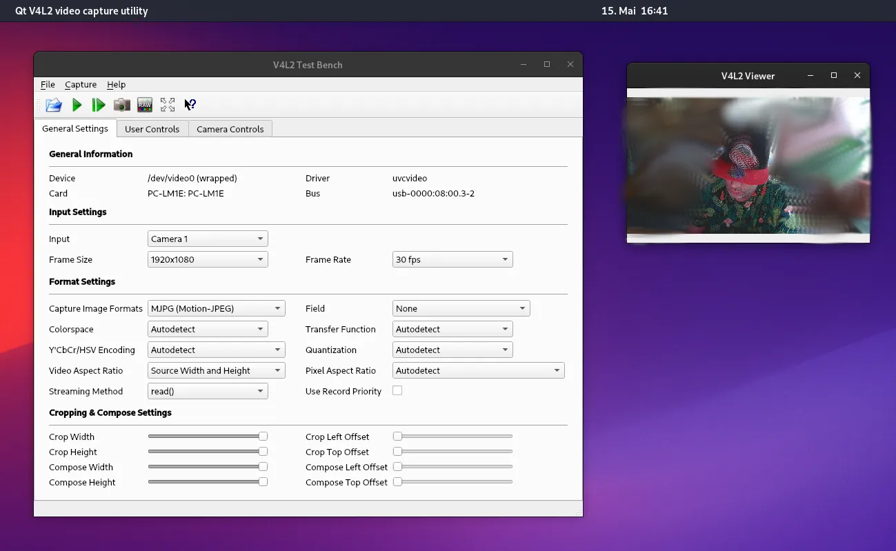

Per default you have at minimum two apps installed you can use to check how the webcam is working basically: v4l2-view ( a simple viewer) and v4l2-test-bench a qt-based config tool:
v4l2 test bench and viewer
In most cases setting done here will get used if you use the cam in other applications like Jitsi or even zoom skype or other crap you have to use ;)

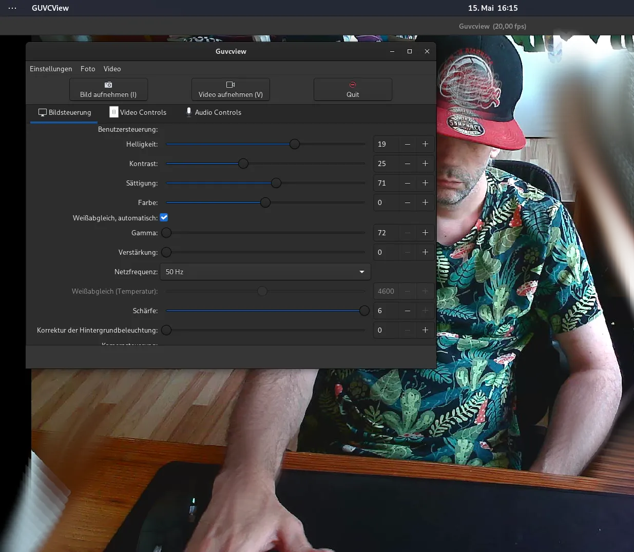

There are a bunch of webcam clients/apps you can use on Linux on my testing a lot of them do not work properly, but I find GUVCView working smooth and without issues right out of the box.
And the app has both GTK and QT versions to choose from for installation:
community/guvcview
Simple GTK+ interface for capturing and viewing video from v4l2 devices
community/guvcview-qt
Simple Qt interface for capturing and viewing video from v4l2 devices
GUVCView gtk version
