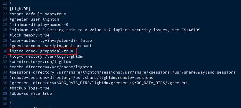

  1. Lightdm fails to start at all (black screen with no login GUI showing up)
lightdm has an issue where it sometimes happens that it starts too fast - before X is ready, or even before the GPU driver is fully loaded. One solution is to set logind-check-graphical=true inside lightdm.conf
uncomment the line #set logind-check-graphical=false and change from false to true like so:
There are several different cases where Lightdm can fail to start, most often it is the case that the GPU driver is not loading at all or too late. that makes X system fail to be available for lightdm.
It can be also be a typo or a wrong setting in the config file/s, as EndeavourOS is using lightdm-gtk-greeter - per default it can be missing one of the needed packages ( lightdm lightdm-gtk-settings lightdm-gtk-greeter) causing it to fail to start.

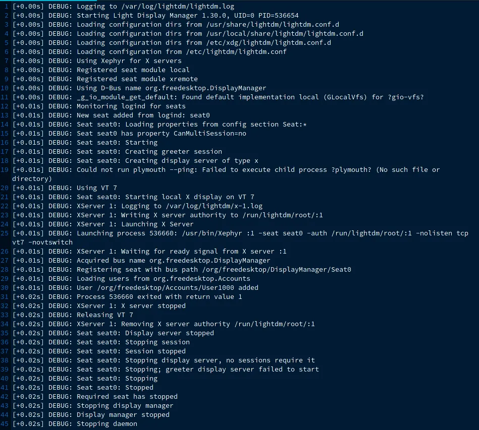

Lightdm has also build-in debugging mode you can start from CLI if it fails:
lightdm --test-mode --debug
You can also run this from terminal if X is running.
Maybe you need to install Xephyr:
sudo pacman -S xorg-server-xephyr
will give a debugging log like this:
Going through the debugging output you can usually find the culprit that may be causing the issue for you.

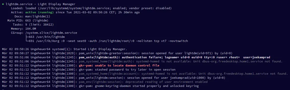

As the status mostly do not give helpful output:
Terminal window
systemctl status lightdm
