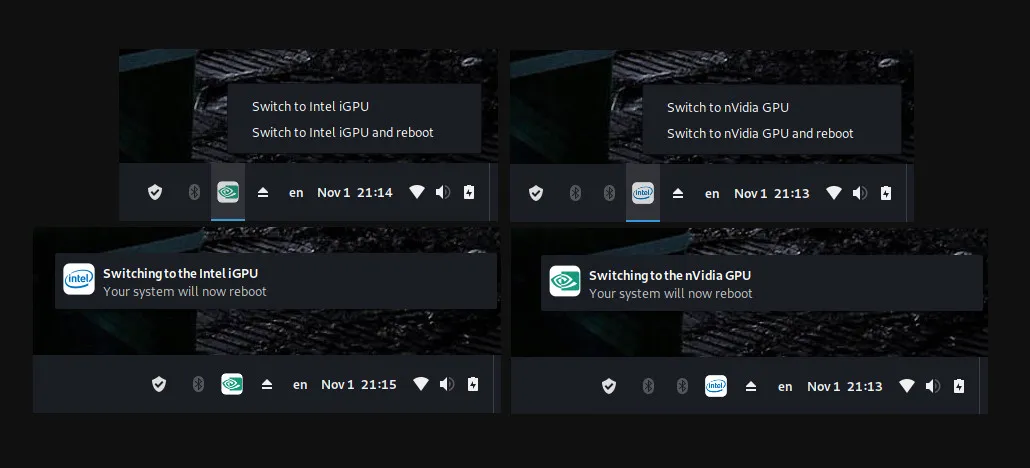

Installing the GUI Indicator/ Switcher Optimus-Indicator
If you are like me, you prefer doing things with a GUI. Also, it would be nice to have an indicator of some sort in the system tray. Because of this, I wrote a program for Optimus Switch that provides not only an indicator, but a way to switch “modes” right from the system tray. It is called Optimus-Indicator. It works with all major Desktop Environments and can be found here:`

All Desktop Environments
There should now be an icon displayed showing which GPU is in use. Click on the icon and it will bring up a menu allowing you to switch GPU’s and automatically reboot your system.
