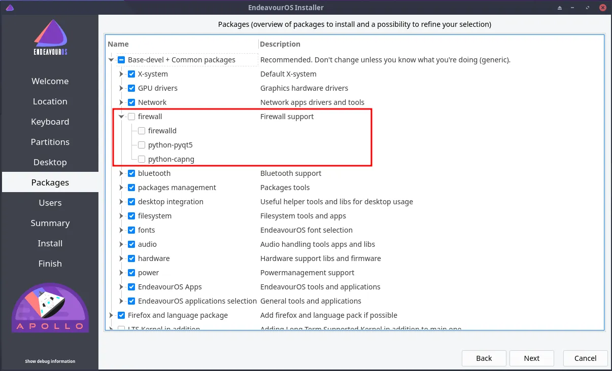

It is also possible to untag FirewallD inside the installation process if you do not want it to get installed.

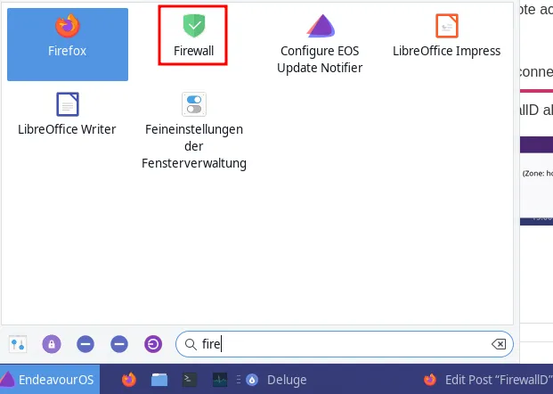

GUI is available as firewall-config which comes with firewall-config package.
You will find the GUI inside the menu as firewall:

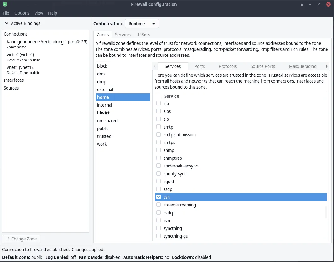

common view of the firewall-config GUI application
The GUI can look a bit intimidating at the first look, but once you understand it has anything you need right at your fingertips.
In the end, for normal Desktop usage, you do not need to change anything, and if you want to use something like open your system for remote access via ssh a simple click on the ssh services and you open the needed port for it to work.

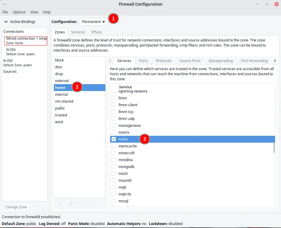

Section titled “Open FirewallD for network printing:”If you missed that and want to open the firewall manually for Network printing support use the firewalld-application:
Switch to permanent configuration and change zone to home. You will see mdns Services are enabled with it.
To switch the zone for your current location (Network) click options > change zones of connections > select the used network connectiona nd select home from the dropdown in the popup:
This will be permanent over reboots, as long as you are connected to the same Network (location).
