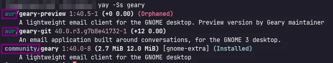

You can identify where it finds the search term as a package or AUR build-instructions-files in the output:
