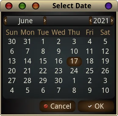

Here is the date selection screen: Using it should be obvious… Click on the date desired, then OK.
