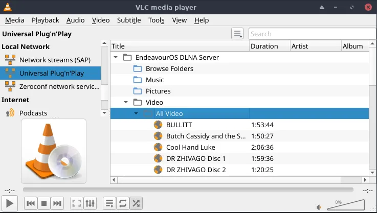

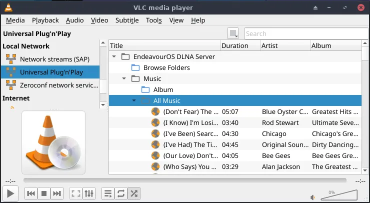

Using a Smart TV, Windows MediaPlayer, VLC, or other DLNA enabled device on your LAN, see if it will recognize the EndeavourOS DLNA Server. To use Rhythmbox, ensure grilo-plugins and dleyna-server are installed. Then enable grilo plugins in Rhythmbox’s Options –> Plugins tab.
To use DLNA with VLC, if the Playlist column is not visible on the left side, click on the “View” tab and click “Playlist”. Scroll down to “Universal Plug’n’Play” and click. EndeavourOS DLNA Server should be listed.
For audio, I know mp3, ogg, flac, and wma are supported, as long as the DLNA client supports those formats. VLC on a PC supports all four. My SMART TV, not so much.

For Video, mp4 is supported, not sure about any others.
These are the major formats. Experiment around and see what else is supported.
You can also select and view your MP4 movies on VLC.
