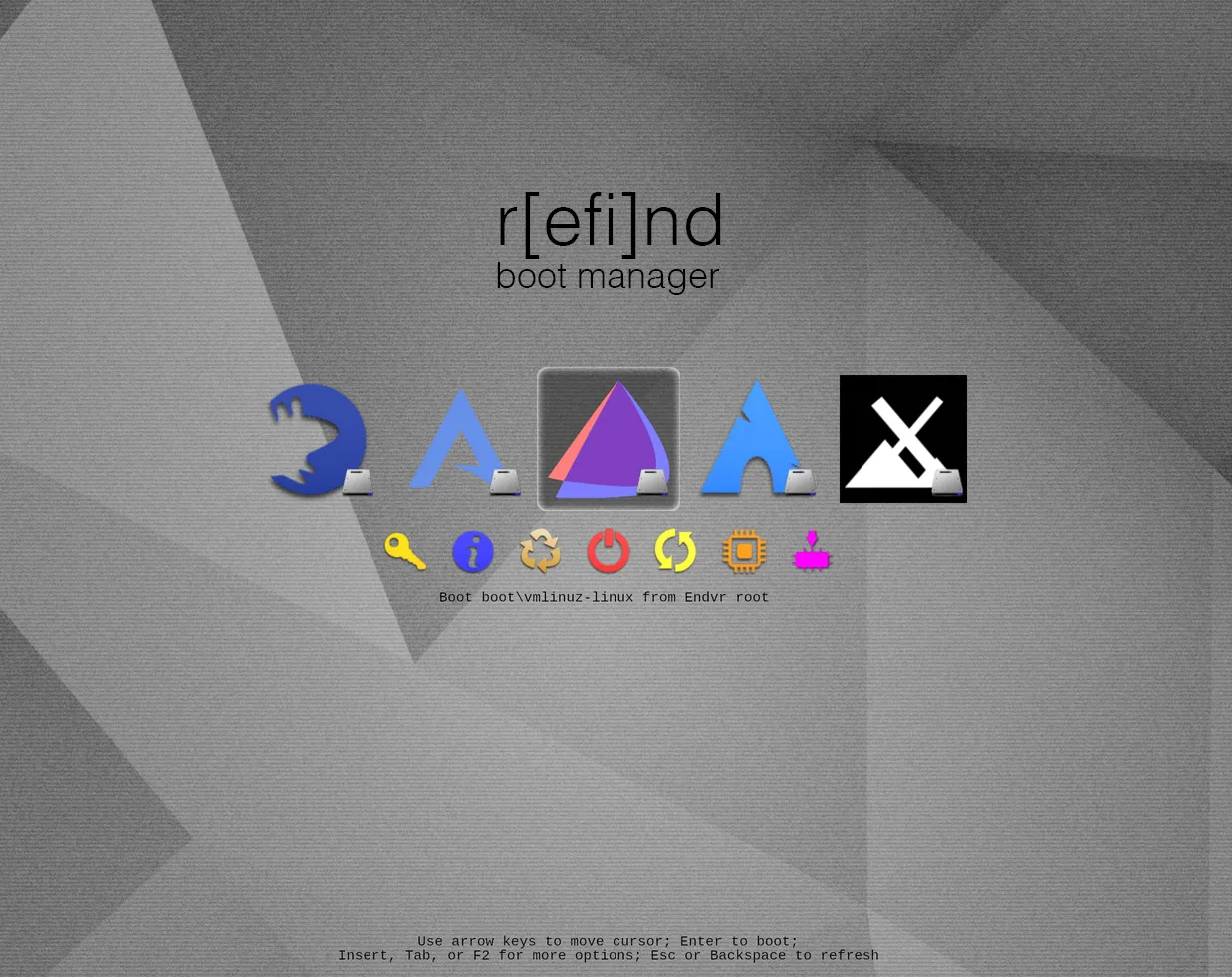

The chances are excellent that you now have already the capability to boot with rEFInd in control. If you try it right away, you will most likely see 2 entries for each bootable system on your computer. If you have only 2, for instance Ubuntu and EndeavourOS, there should be 4 choices on the screen. If you see a lot more than that, did you remember to remove the USB stick you installed from? Reset and try without the stick plugged in! OK, you’re back (or never left). As you use the arrow keys to highlight each of your choices, you will notice that a description of the file that will be booted shows up underneath the row of logos. One entry for each will be for grubx64.efi and the other will be similar to the vmlinuz-linux as EndeavourOS uses. Either icon will work. There are other easy things you can do to simplify, or beautify it from here.

Section titled “4. Hide the extra entries (optional)”If you want to simplify your visible boot options, you should decide which method of booting suits you better – either by starting up the grub system that was created on the original installation (or by subsequent updates) or by directly booting the OS. As you highlight each choice, under it is a description of the boot file it will use. If it says the file to boot will be \EFI\endeavouros\grub64.efi, it will select and boot the grub entry, from which you can choose the item you wish. If it says that it will boot from \boot\vmlinuz-linux, it will do a direct boot. Highlight the item of your choice that you wisk to hide, and hit the DELETE key and it won’t be seen again. To UNhide an entry if you change your mind, choose the recycle tool (Manage Hidden Tags menu) on the lower line.
