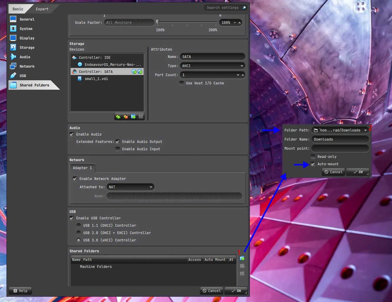

Section titled “Notes / Troubleshooting:”Add shared folder to be shared between host and guest:
Section titled “Add shared folder to be shared between host and guest:”
Open the Settings and click on shared Folders.
Add a share [1] and give the needed path to the host folder [2] finally mark it to automount [3]
On the booted guest (inside the VM):
sudo pacman -S virtualbox-guest-utils
sudo systemctl enable vboxservice.service
→ reboot vm
sudo modprobe vboxsf
sudo usermod -aG vboxsf $USER

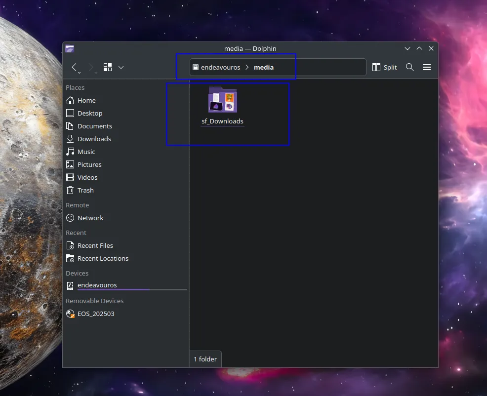

After a reboot of the VM you should be able to access the shared folder as the normal user inside the VM.
You will see it created a folder named sf_<hostfoldername> under /media/sf_<hostfoldername>

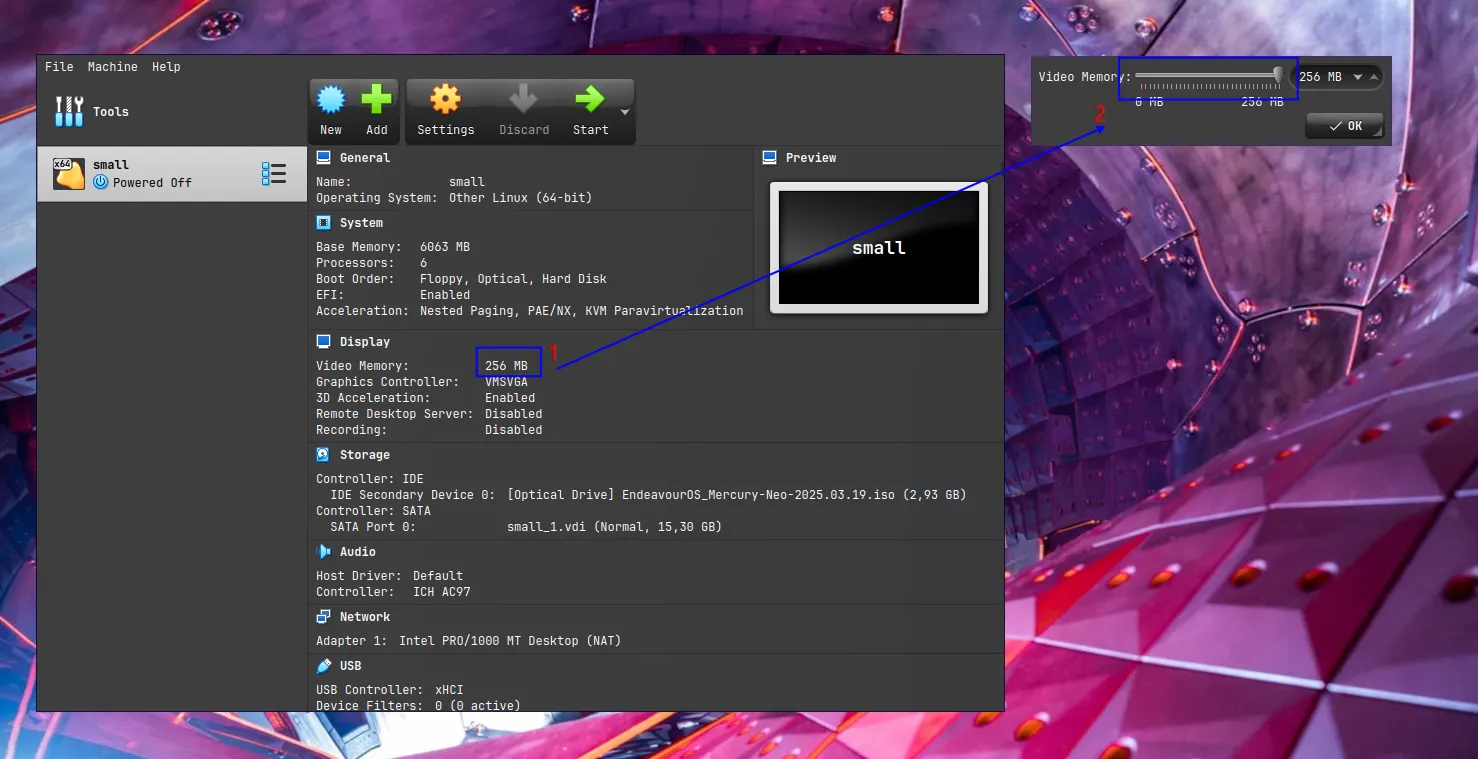

Graphics Memory:
Section titled “Graphics Memory:”From that screen you can set Memory for Graphics bigger than 125 MB what is recommended to set, same for 3d what should be checked.
Click on the MB value [1] it will open a popup [2] slide it to maximum of 246 MB and hit OK.
3d should be enabled for wayland guests in case it is causing issues… disable it again.
As it happens in some circumstances, that Live ISO per example does not show display if enabled.
