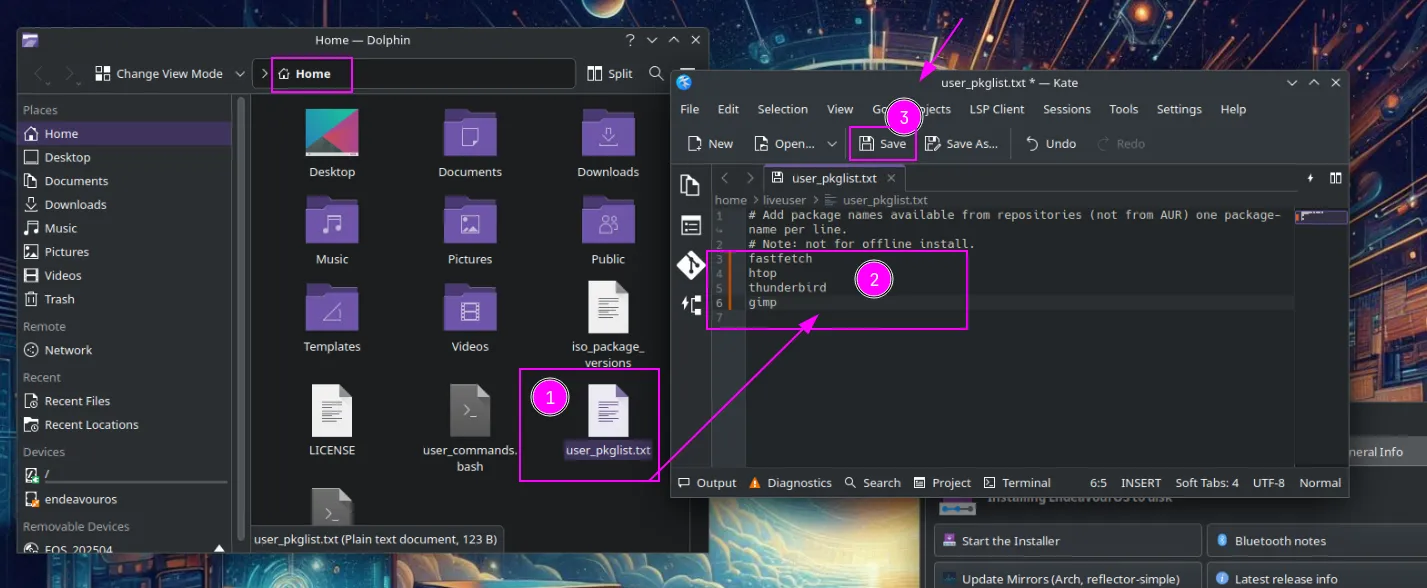

User Packagelist
Section titled “User Packagelist”File /home/liveuser/user_pkglist.txt
This is the easy way to add your favorite package names to be installed. After booting up the installer USB:
- open a terminal
- run command
nano ~/user_pkglist.txt
and add the names of packages you want to install to the file - close the Welcome window
- start Welcome again with command
eos-welcome

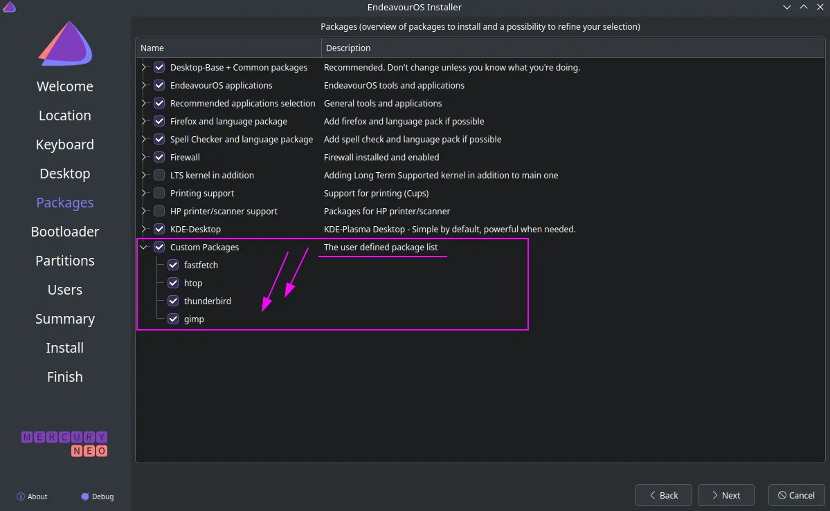

You will find a group added on the package screen of the installer where you can see the added packages too:

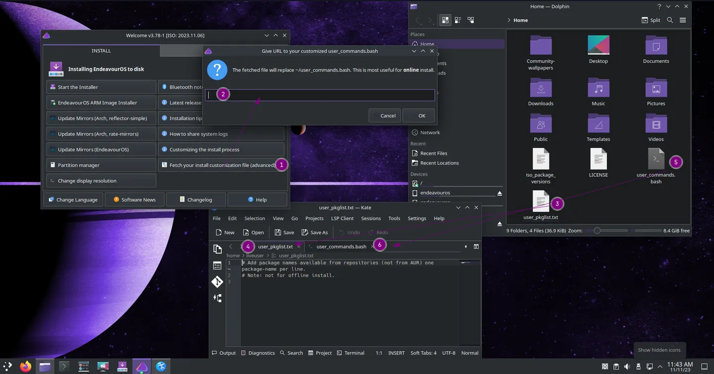

How to start a customized install
Section titled “How to start a customized install”Simply write your commands into user_commands.bash and restart Welcome.
Or, you can use your personal URL file which contains your commands! To use the URL, re-start welcome with a terminal command:
eos-welcome --ni="URL"
and welcome will fetch your command file and use it as user_commands.bash.
Note that the URL must start with either https:// or http:// because only these protocols are supported.
