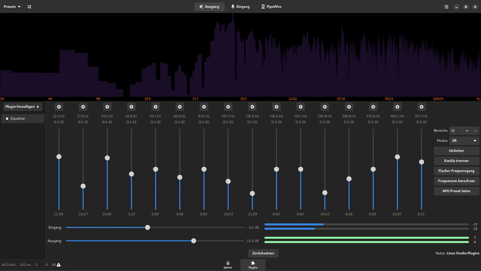

easyeffects
Audio Effects for Pipewire applications

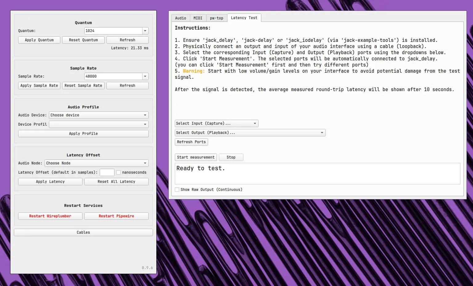

Cable
https://github.com/magillos/Cable
PyQT GUI application to dynamically modify Pipewire and Wireplumber settings at runtime. Now, with side by side connections manager

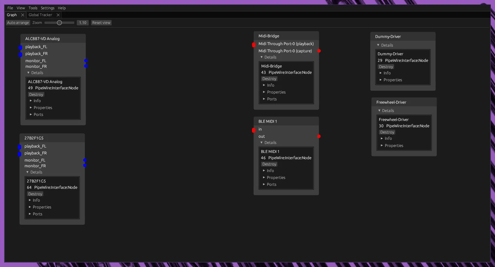

Coppwr
https://github.com/dimtpap/coppwr
Low level control GUI for PipeWire

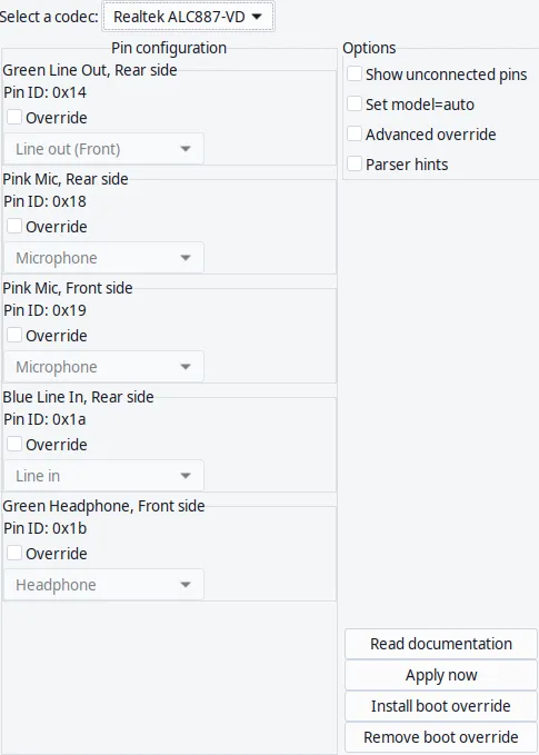

Hdajackretask
https://github.com/alsa-project/alsa-tools/tree/master/hdajackretask
part of alsa-tools package (only for hda_intel driver audio chips)

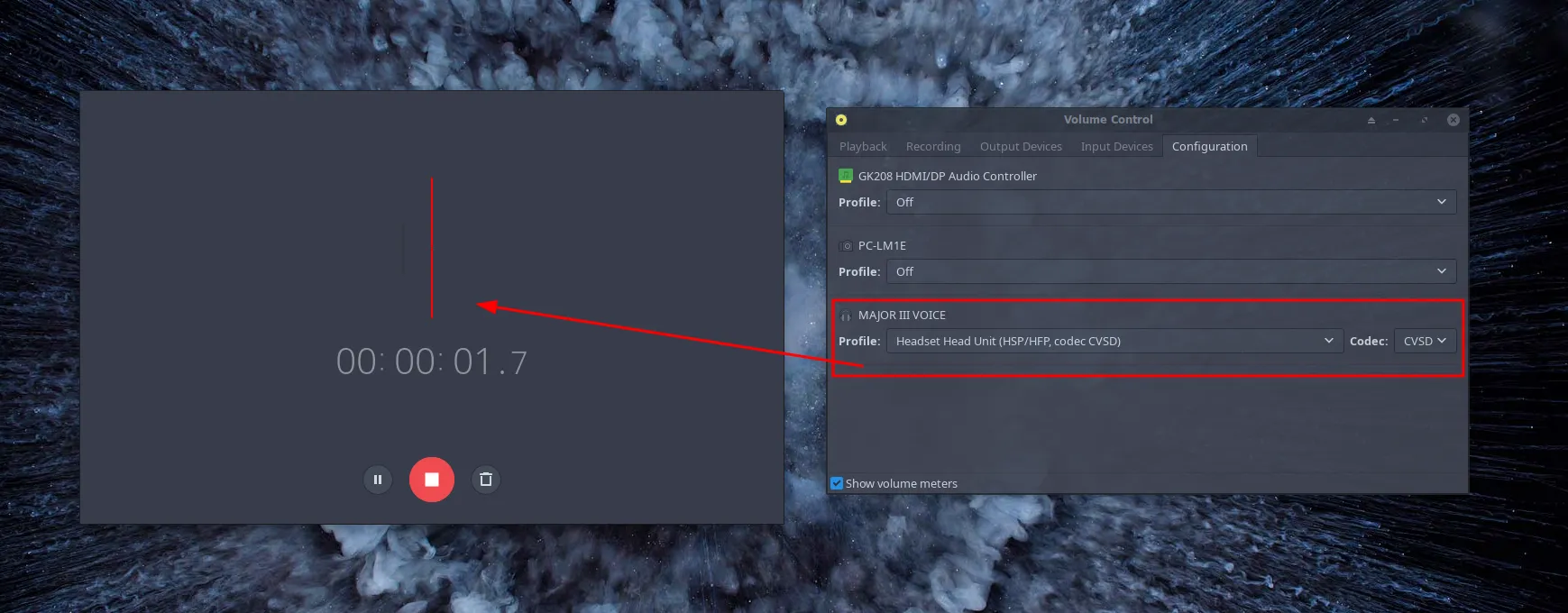

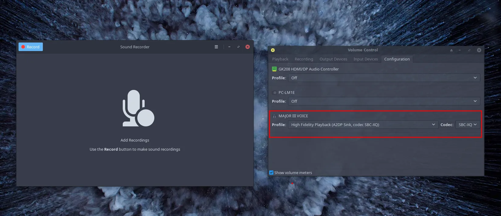

Automatic switching Bluetooth Headphone into Headset mode if you need Headset mode for microphone usage:
Section titled “Automatic switching Bluetooth Headphone into Headset mode if you need Headset mode for microphone usage:”
https://forum.endeavouros.com/t/pipewire-stable-enough/16944/29?u=joekamprad
it will not switch automatically, this needs to be enabled..
This will only work if pipewire-media-session is installed for wireplumber you need to use a different setup.

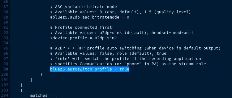

mkdir -p ~/.config/pipewire/media-session.d
cp /usr/share/pipewire/media-session.d/bluez-monitor.conf ~/.config/pipewire/media-session.d/bluez-monitor.conf
nano ~/.config/pipewire/media-session.d/bluez-monitor.conf
and uncomment the line bluez5.autoswitch-profile = true and set it to true ….
save the file .. restart system or services:
systemctl --user restart pipewire pipewire-pulse
Working exactly as it says… if you start recording it enables Headset profile and seamlessly turns it back of, when you are stop recording…
Headphone mode when not recording // Headsetmode when recording
