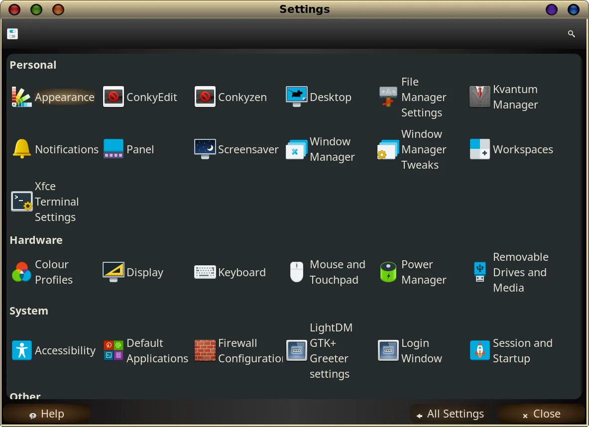

To begin - here is a screenshot of the Settings app for XFCE.

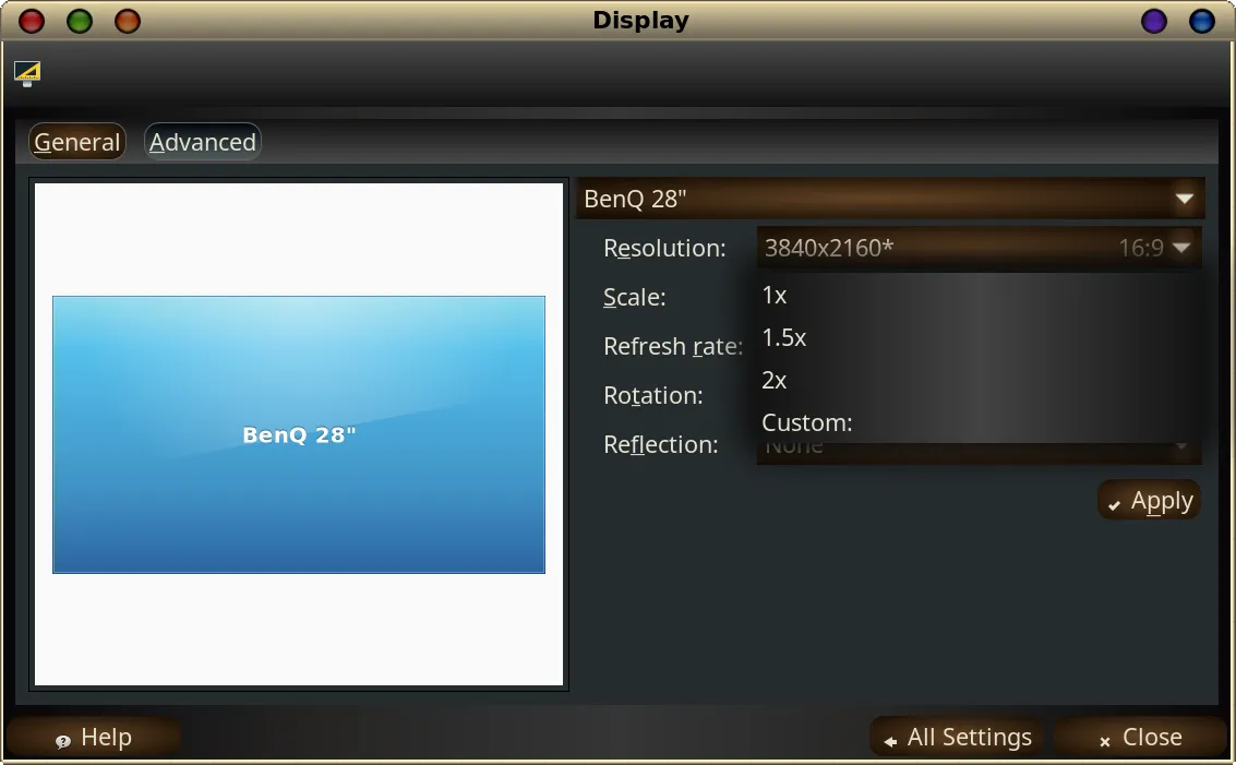

First off, there is a possibility that you would be happy with a simple scaling change, that changes the effective resolution to a value other than what you actually have. If you would be happy with such a change, there are two ways to achieve it. One is to use the Settings/Display application,
and select the resolution you consider correct for your use. If you have, for example, a 3840x2160 monitor, you could choose 1920x1080 as your resolution - giving you half the screen real-estate, with items on it at double the size. Another choice might be (depending on your hardware) 2560x1440, which would give you about 75% of the original resolution - or an increase in size of about 150% of the features (and fonts!) on your screen.
There is also a Scale option there that allows changing apparent size as well (this is shown as the active choice in the screenshot above). The choices are 1x, 1.5x, 2x and Custom. Strangely, it works the opposite way to what you would expect - choosing 2x will seem to shrink your windows and fonts to half-size, for example, giving you lots of screen real estate, but requiring a magnifying glass to read anything! If I were using this method, I would choose Custom, and a value of perhaps 0.7 - growing the size of the screen contents to about 150%.
This works well, and the system can remember your settings and fire up graphic sessions in that mode thereafter.

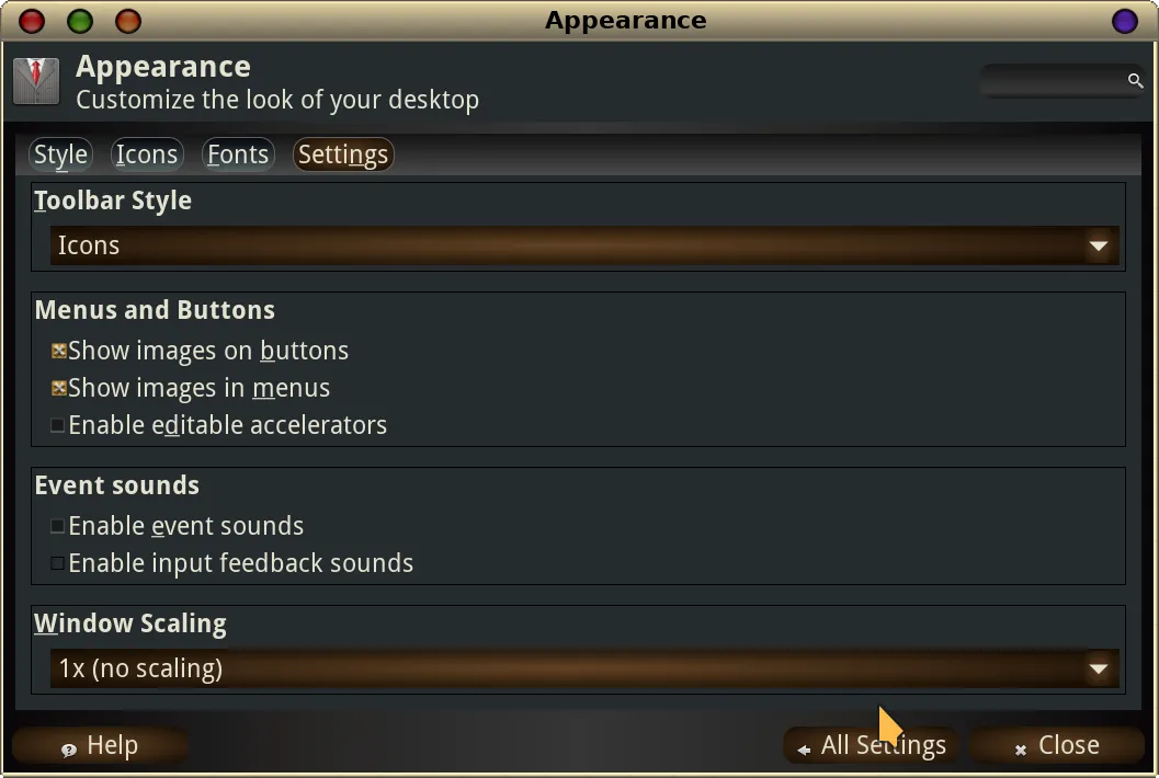

However - if you want to keep your full resolution (especially for graphics), but still want to be able to see and use the features of the User Interface (UI) and the text on the screen, there are other ways. Take a look here at the Settings/Appearance/Settings screen:
Again, there is a Scaling option in the Settings/Appearance/Settings/Window Scaling. This one works the right way around, a scale factor of 2 will double the size of the screen elements. This enables a scaling factor for the system to apply, but it only takes whole numbers (1 or 2 or 3 etc.) which keeps your choices limited. This may be made more flexible in the future, but for now… other options are better.

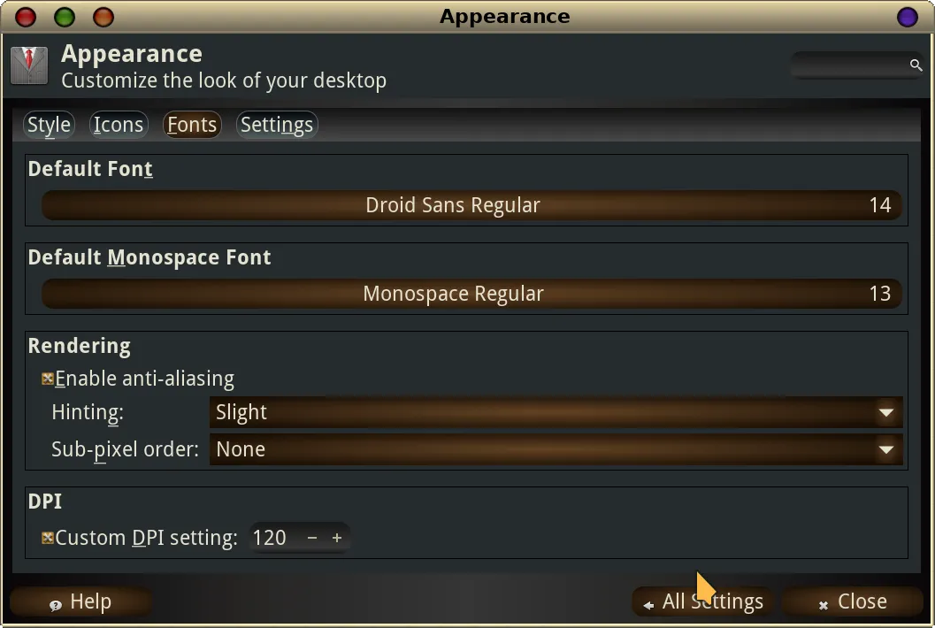

In Settings/Appearance/Fonts/DPI there is an opportunity to make a change. Most setups first come up with 96 dpi selected as standard. One of the most useful settings is to change to 120 dpi - which is a substantial step up without trying to double everything. Just above this, on the same screen, is the rendering setting - where I would recommend you check the “Enable anti-aliasing” box, and select Slight for the font hinting. Experiment if you wish, it can vary.
Now that you can see a bit better, you can choose a font size that works for you in the Default Font and Default Monospace Font categories. Increase these until you are reading comfortably. 12 might do it, 13 is probably OK, but I’m a bit older so I choose 14 on both as a workable and non-tiring option.

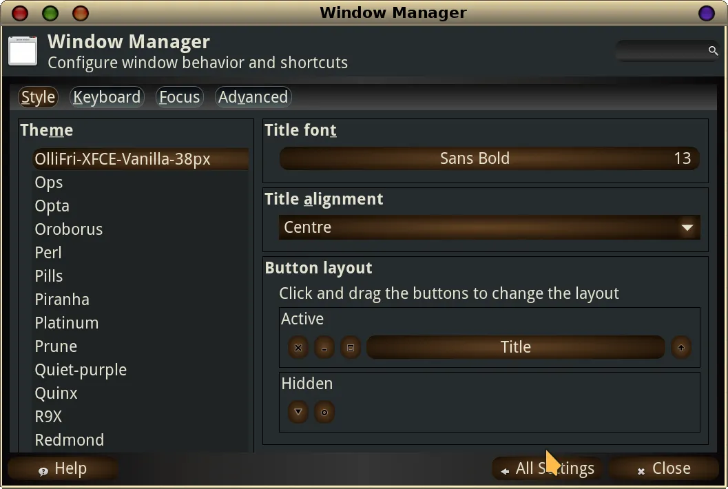

Now, in the Window Manager app, under the Style tab, there are a couple of more changes worth doing. The Window Manager handles the Titlebars and their text, and the ‘outside envelope’ of the window. Again, you can set the font appropriately, probably to the same size (12, 13, 14) as you opted for in the previous section.
This leaves only the size of such things as toolbars (play. pause and stop buttons in a music player for example) to be set up. There are many themes that can be downloaded, and some of them specify the size in pixels of the toolbar. I run with an assortment of XFCE-38px (Found on XFCE-look.org and Gnome-look.org - I like the ones by Ollifri for example - found dated from about April 2018) options, which, again, I find comfortable - and allow sufficient room for the upsized font you chose in the step before. By the way - this is also where you can choose which window control buttons you wish to use, and where they are located on the titlebar. As you see, I move them left (where they were before Windows degraded workflow), and I hide the menu button.
