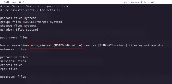

Edit the file /etc/nsswitch.conf and change the hosts line to include
mdns_minimal [NOTFOUND=return]
before resolve and dns:
Restart avahi-daemon and NetworkManager after this, or reboot machine:
sudo systemctl restart avahi-daemon NetworkManager

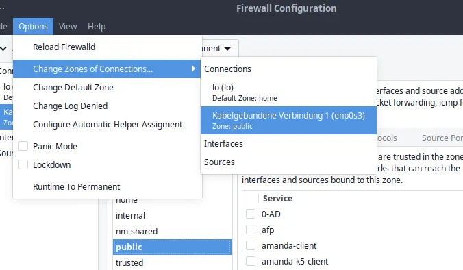

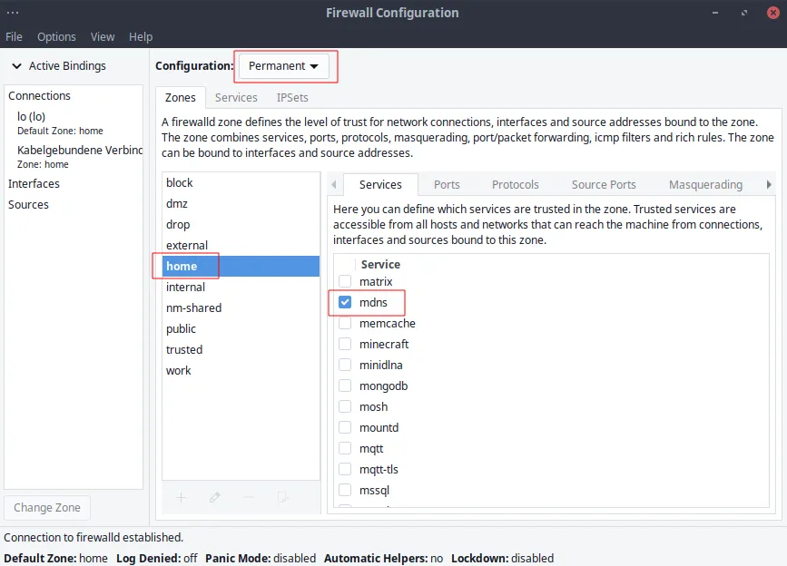

Firewall is blocking mdns:

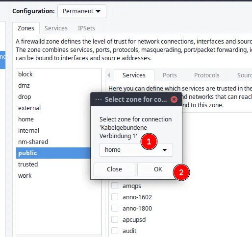

Section titled “Firewall is blocking mdns:”To make use of local hostname resolution (mdns) you need to change firewalld from public to home (zone change).
Assigning a Zone to a device will also be remembered on network changes, so if you leave home network and per example connect to a Wi-Fi network outside it will always use the default set public zone as long as you do not change that manually.
To make these permanent you need to set Configuration to Permanent and run the change to home zone, if Runtime is used it will get reset after logout. Now you should see network printers in printer setup tools showing up.

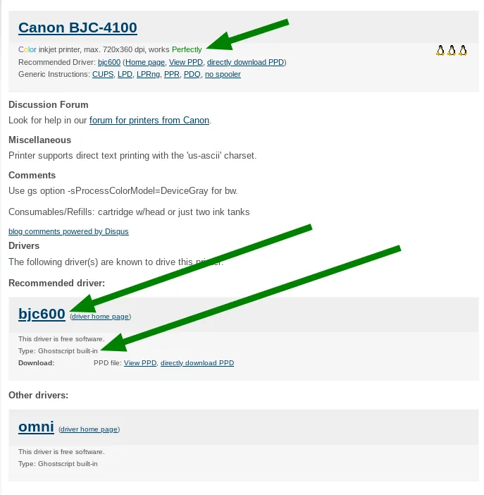

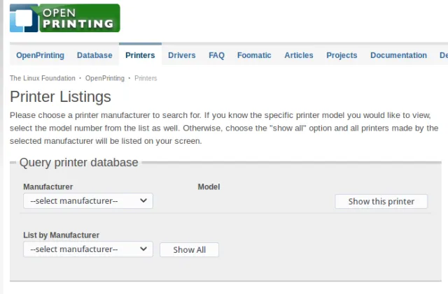

Procedure to find the right driver for your printer
Section titled “Procedure to find the right driver for your printer”Go to the open printing website and search for whether your printer is supported on Linux at all, and what driver options are available.
This is what the result will look like:
- On top you will see whether or not there is a working driver for your printer
- second it will show available driver options, in the example, you see Type: Ghostscript built-in, so go to package search on Archlinux (or use the tool of your choice) you will find GhostScript (already installed if you followed the tutorial from top to bottom)
So install the driver available for your device, and proceed to install and configure the printer. But take a look at these links first, as it could be that your printer needs some extra configuration done to work properly:

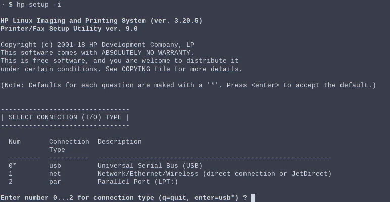

now run the program to install new printer queue and the possibly needed proprietary plugin for some hp-printers:
sudo hp-setup -i for CLI install without a GUI
or run hp-setup from menu.
hp-setup from terminal CLI
The tool guides you through the installation - simply read the instructions.

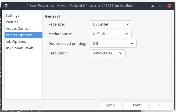

You have your printer added now, so you do not need to set it up again as what follows, but you can use system-config-printer to setup configuration for papersize e.t.c.

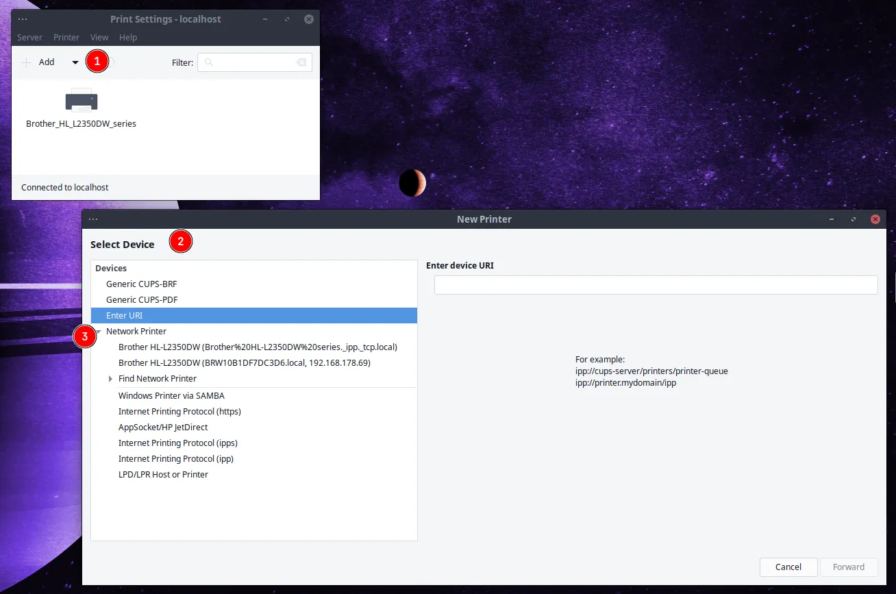

Common printer setup (not if hplip is used):

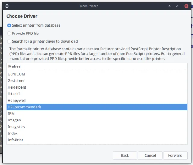

Section titled “Common printer setup (not if hplip is used):”Use the system-config-printer tool to find and set up your printer:
