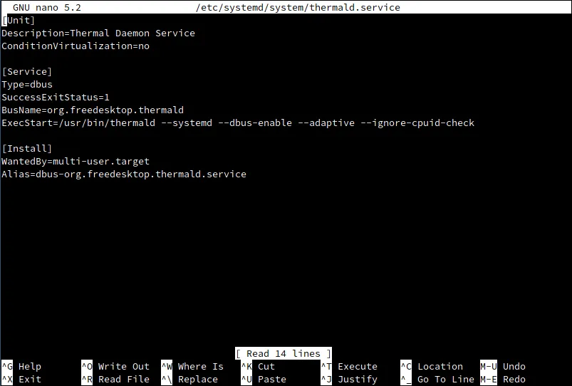

As each update of the thermald-package will overwrite the service file we need to move this to
/etc/systemd/system/So that it will not stop working after thermald updates.
install needed:
sudo pacman -S --needed thermaldsudo cp /usr/lib/systemd/system/thermald.service /etc/systemd/system/sudo nano /etc/systemd/system/thermald.servicechange the line:
ExecStart=/usr/bin/thermald --systemd --dbus-enable --adaptivelike so:
ExecStart=/usr/bin/thermald --systemd --dbus-enable --adaptive --ignore-cpuid-check
save the file by pressing [Ctrl+Alt+x] and confirm by typing “y”
The last two things to do is enable the systemd service for Thermald to automatic start it on every boot of your system:
sudo systemctl enable thermaldand now please reboot the system to make it start working.
