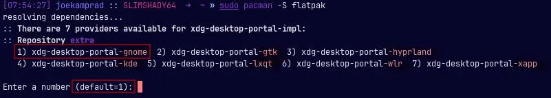

  1. Once the update is complete, we need to install Flatpak support.
sudo pacman -S flatpak
Be aware to check the right xdg-desktop-platform package in the install process!
In cases on some Desktops (aside from Gnome and KDE) it will install xdg-desktop-platform-gnome as default selected, and you ma yneed the one fitting your Desktop/WM in use.
xdg-desktop-portal-gnome will only work on GNOME Desktops and can cause a lot of issues in other Desktops!
