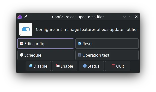

Configurator of eos-update-notifier
Section titled “Configurator of eos-update-notifier”
A small GUI program for configuring the EOS update-notifier is eos-update-notifier-configure. It can:
- edit the configuration file /etc/eos-update-notifier.conf
- start the scheduler that defines when updates are checked (see below)
- reset the scheduling timer to the factory default
- show the timer status
- run eos-update-notifier once to see if changes are OK
It can also show the changelog (git) of the eos-update-notifier program.

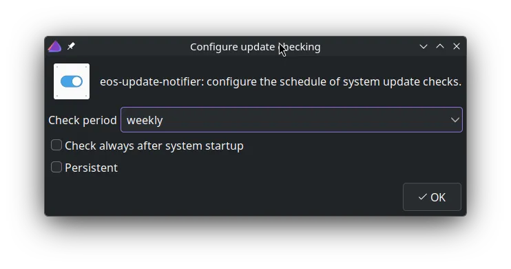

Section titled “Configuration”Schedule checking: the GUI way (v1.8-2)
Section titled “Schedule checking: the GUI way (v1.8-2)”eos-update-notifier -conf
The configuration window looks like this:
