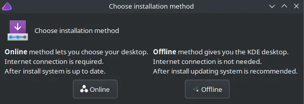

⚠ Generel Warning: Online is the default option to be used, offline installs are only a fallback option in case of network/internet connection issues (or hardware driver issues with network devices)
Section titled “⚠ Generel Warning: Online is the default option to be used, offline installs are only a fallback option in case of network/internet connection issues (or hardware driver issues with network devices)”Online installation method

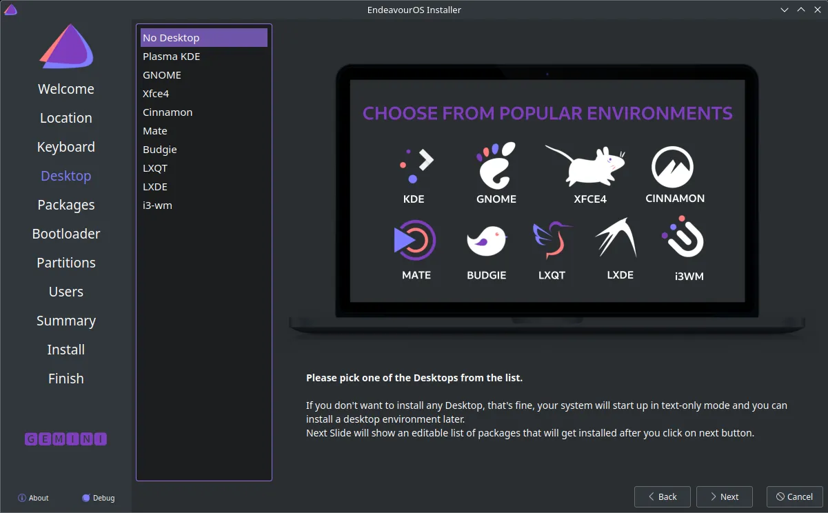

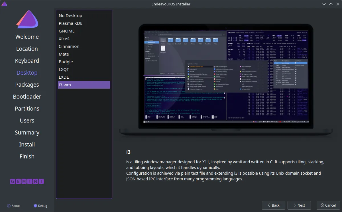

Section titled “Online installation method”This is the recommended way to use the installer. It provides all available desktop environment options and allows you to deselect packages or add extras such as the LTS kernel or printing/scanner support.
With this method, the system is built and configured in a way very similar to a manual Arch Linux installation: everything is created and installed from scratch, using EndeavourOS configuration and packages freshly pulled from the mirrors.
The result is a fully up-to-date system with your preferred desktop environment.
Offline installation method
Section titled “Offline installation method”This is only a fallback option. It installs package versions from the point in time when the ISO was created. It can only install the KDE/Plasma desktop and does not allow you to choose another desktop environment in the installer.
The offline method runs entirely without an internet connection, which helps in cases of slow/unreliable connections or network hardware/driver issues.
⚠️ Important warning: The system will not be up-to-date after installation. On the first update, you may need to resolve issues manually due to changes that happened between the ISO creation and the current package versions.
Before running the first update on a fresh offline install, it is recommended to check for known update issues.

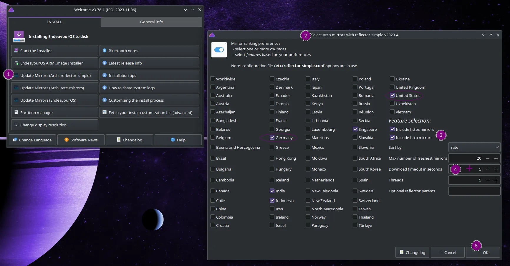

Slow Internet unstable Connections

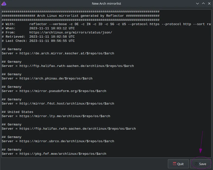

Section titled “Slow Internet unstable Connections”In some places, you do have not that stable internet connection, or you are connected over Wi-Fi with a bad bandwidth. Another reason can be restrictions from ISP so that you can not reach servers.
We have some implementations built in to detect and rank mirrors, but the procedure is known to not work in some parts of the world where you have only some not stable mirrors (India, Pakistan, Brazil p.e.).
In this case, the best to do is to use the “update mirrors” tool from the welcome application:
Make sure the resulting mirrorlist has at least 8 mirrors showing up, and save it.
Now start the installer, and you will be able to install via the online option.

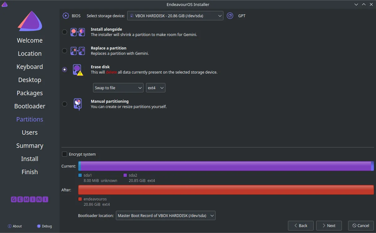

Partition

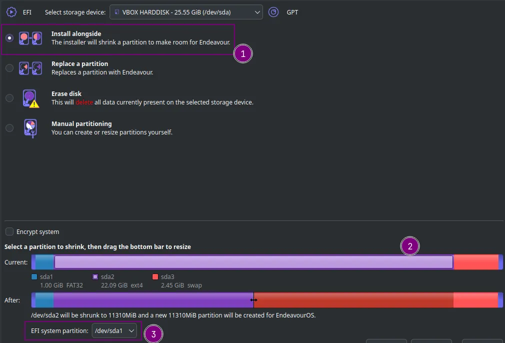

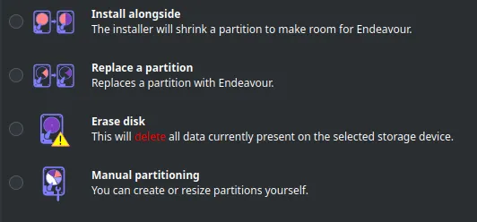

Section titled “Partition”The easiest way is to use the automatic options to partition your drive/s, you will find 3 main options to apply that:
Alongside: this will shrink the main system partition of the drive selected and add all needed partitions automatically, in case you can choose to create a new ESP in any case too also an existing one already would fit the minimum requirements:
Replace: useful in case of reinstall to overwrite one partition only and leave the rest intact.

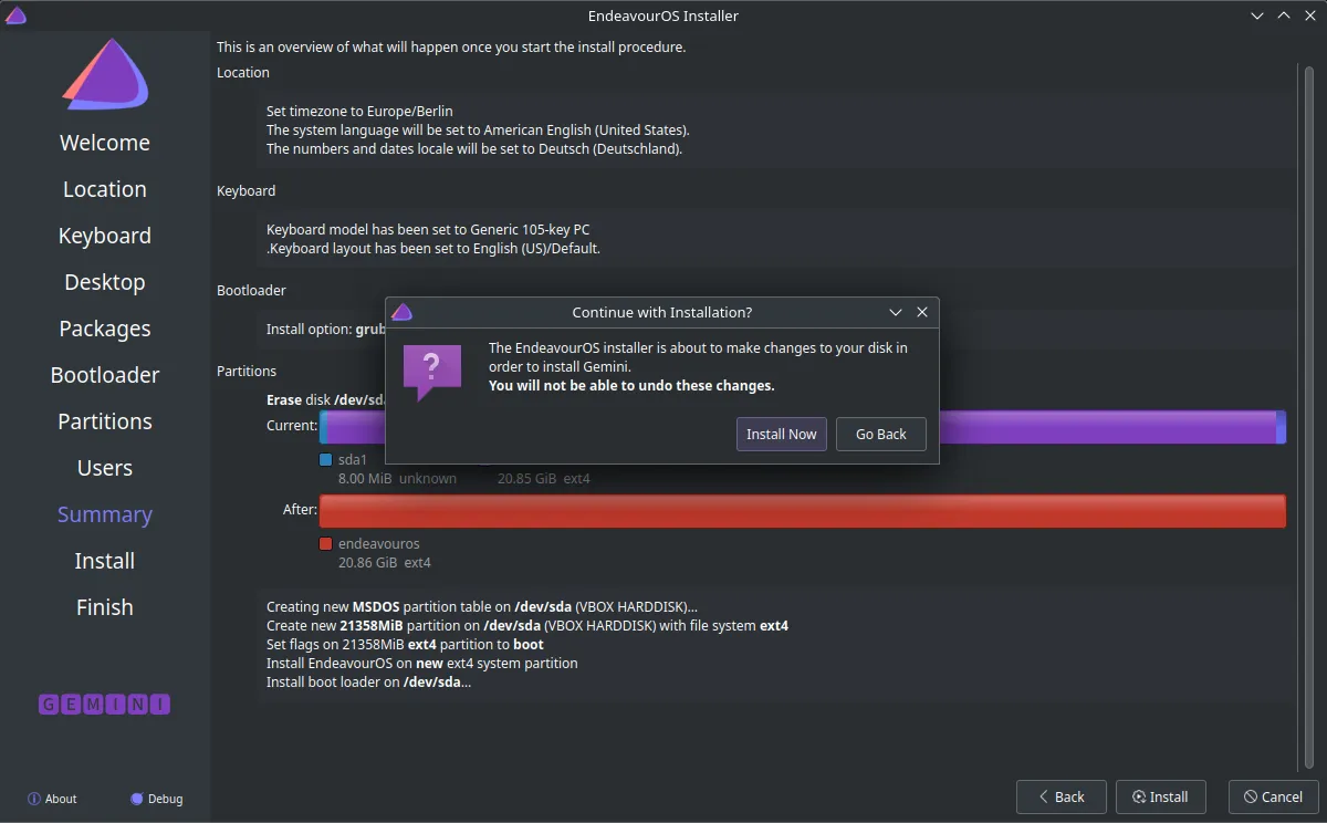

Erase: this will simply use the complete drive and create everything new, deleting everything ion the selected drive!
Manual partitioning:
This is advanced usage! Handle with care.

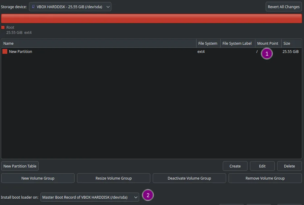

Older (legacy) Bios Systems:
Section titled “Older (legacy) Bios Systems:”If you can only boot into CSM (Compatibility Support Module) or on real older non-efi Bios systems.
This could be the case if Windows is installed in that mode already, and you do not want to reinstall Windows in EFI mode.
You have 2 Options here:
First Option: is the old standard using the MBR (Master Boot Record, first sector of a hard disk):
Bootloader will get written into the MBR of a msdos partition table, here you need only one System Partition,
mounted as /, flagged as boot.

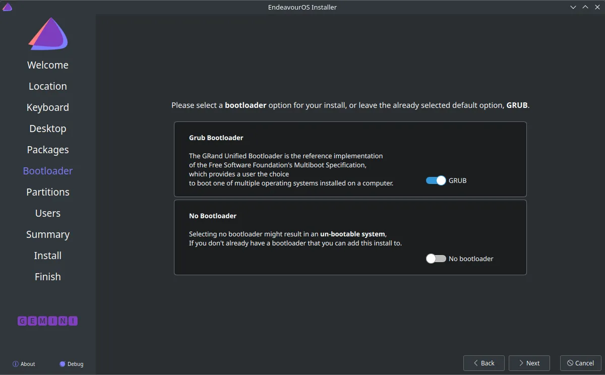

In this case, Bootloader will get installed onto the “grub-drive”.
If you choose BTRFS it will create a preset of subvolumes with automate partition options, and on manual partitions it will resolve subvolumes too.
ℹ Recommendation is to only take BTRFS if you know why you would need to, it is not only another faster more fancy filesystem, and needs some knowledge to earn beforehand!

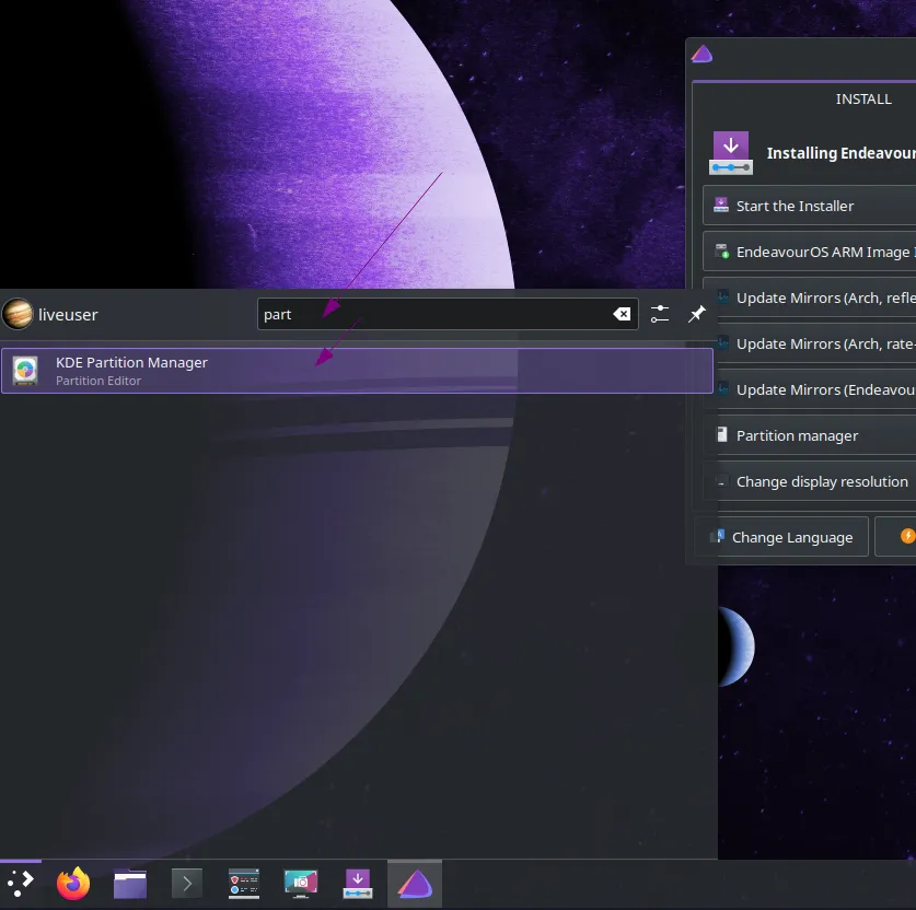

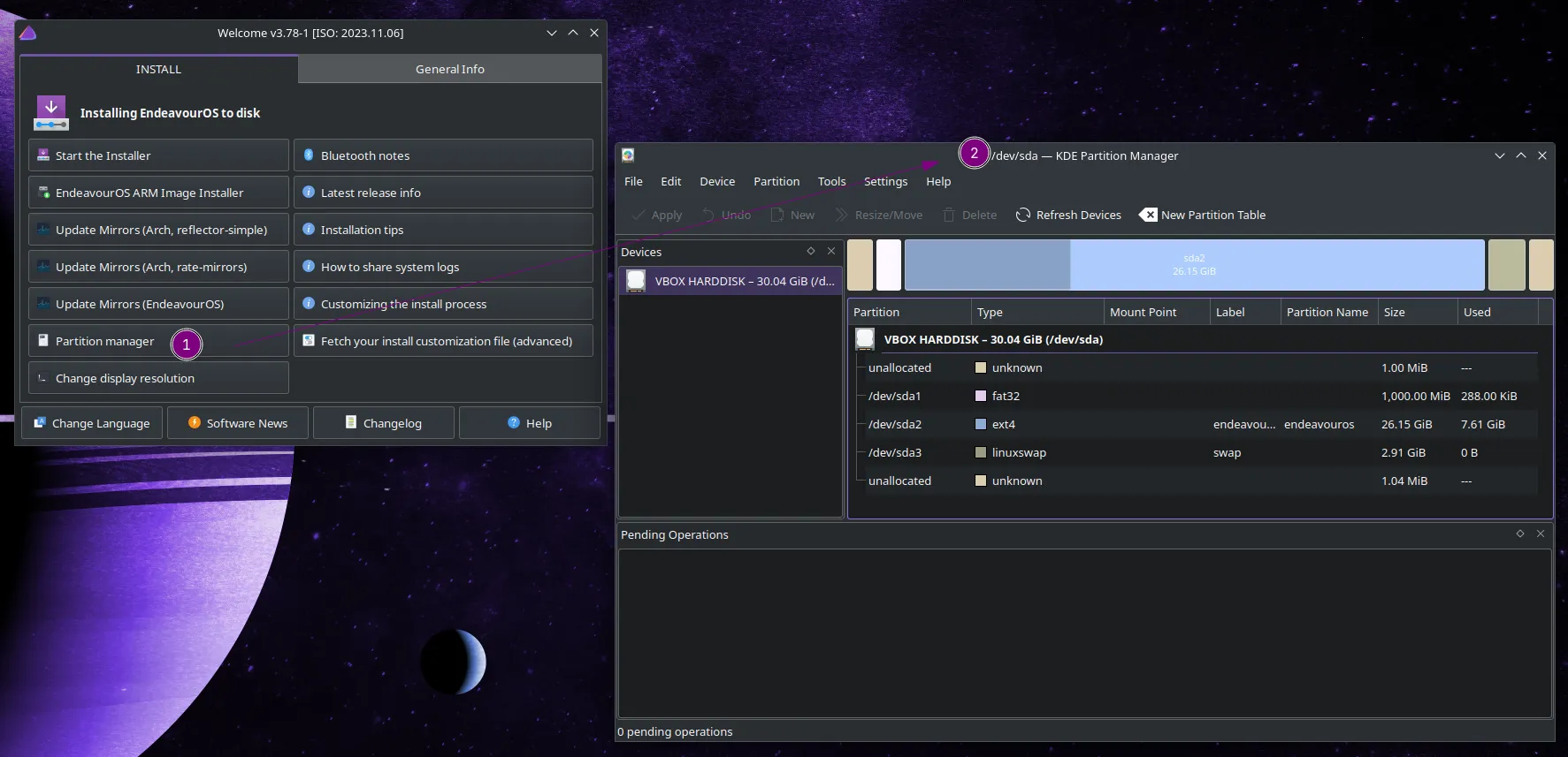

Installer can not create partition
Section titled “Installer can not create partition”In some cases, it is a good thing to delete the partitions you want to use for EndeavourOS before starting the installation. You can simply use KDE partition Manager, which you can start with the button in the welcome app or via the menu of the live environment.
In 2024, we added GParted in addition, to the ISO for your convenience.

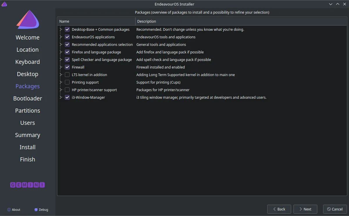

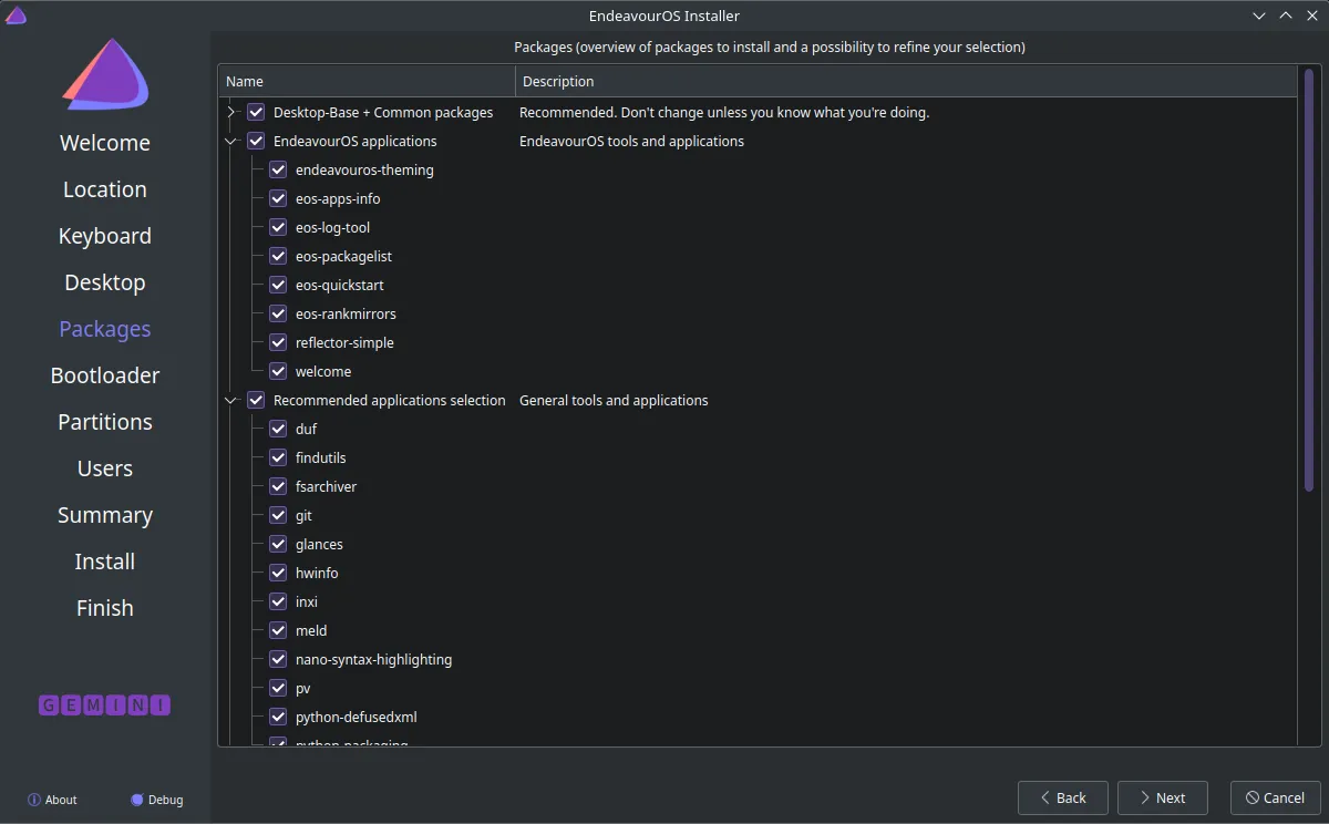

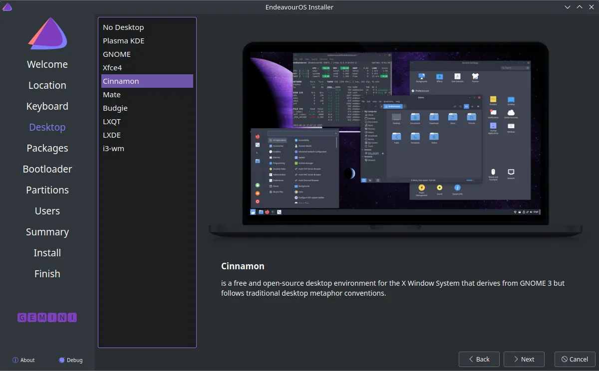

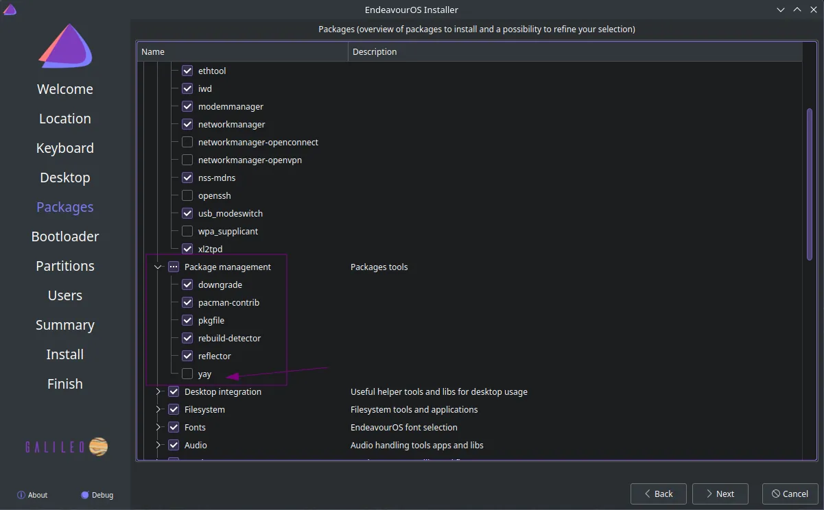

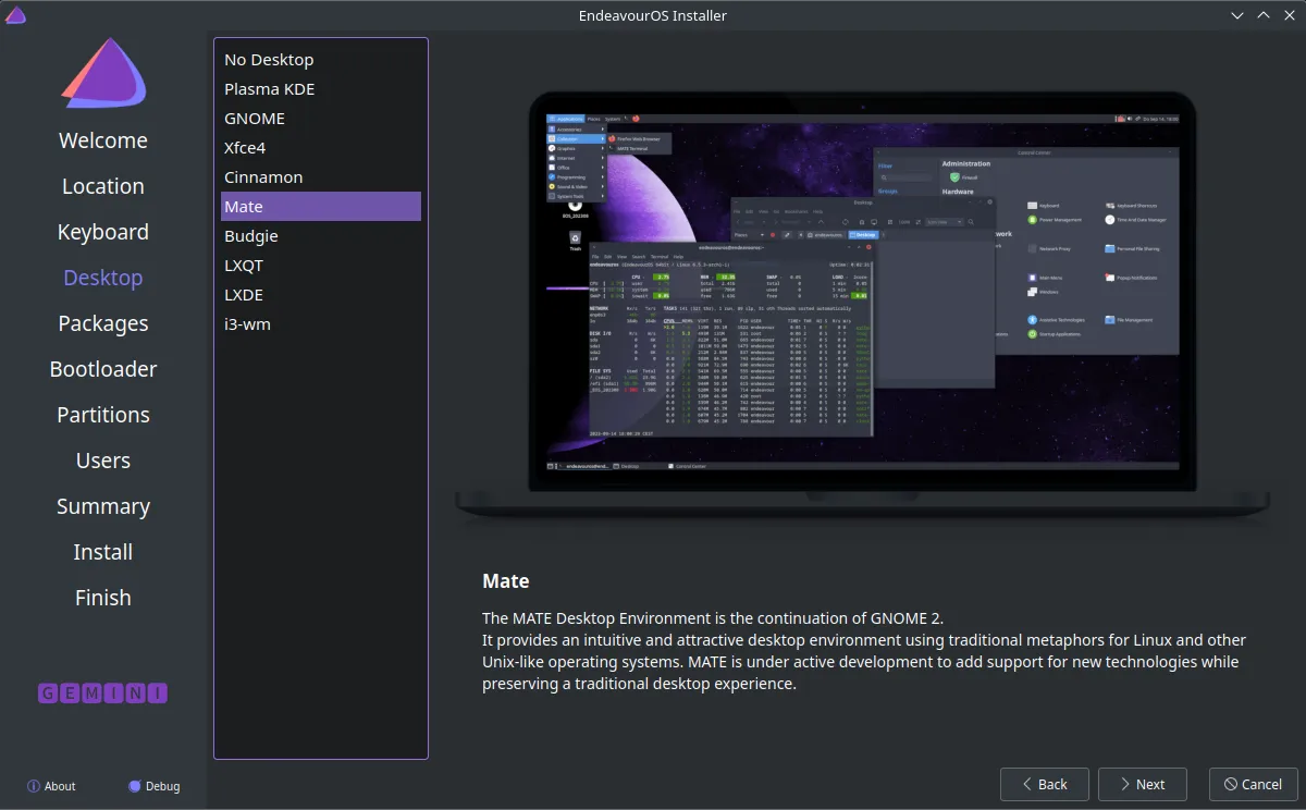

Section titled “Advanced installer options”You can unselect packages you do not need:
This option is only available for online install method!

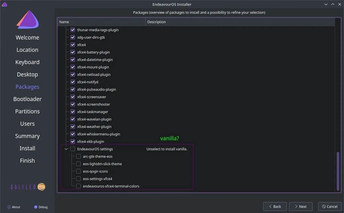

EndeavourOS Desktop Fixes and Theming
Section titled “EndeavourOS Desktop Fixes and Theming”EndeavourOS has preset small changes to the settings and themes for all desktop installations to fix problems with the default settings and smooth the interfaces. In addition, installs for other environments (like i3 or sway) will offer some more complete setups to be able to start with a usable Desktop.
If you want an unchanged installation, you can easily turn off these changes by deselecting the appropriate subgroup:

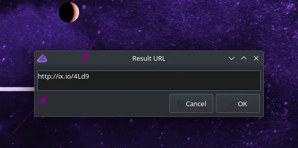

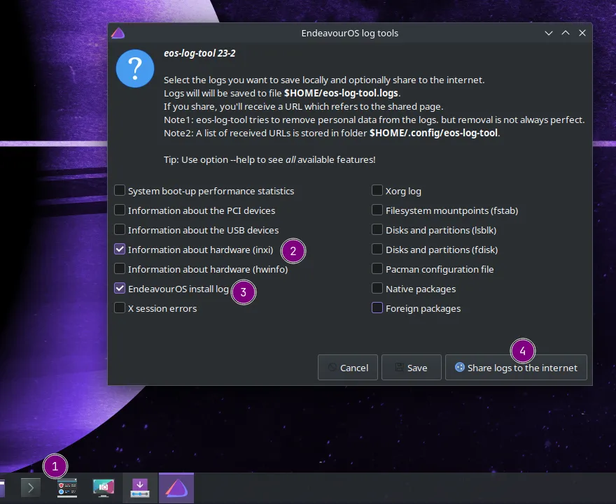

Section titled “What to do if install fails or i have issues?”In case the installation is not successful, do not reboot or exit the live session! Please send us the installer log on the forum, or over telegram chat, we can always make great use of them to fix issues and bugs with the installer:
You ca use the log tool from the panel and send log to Pastebin (internet connection required).
Run the log tool with inxi and install log tagged:
And post the URL it creates in this little popup window on forum, chat or send it via email:
